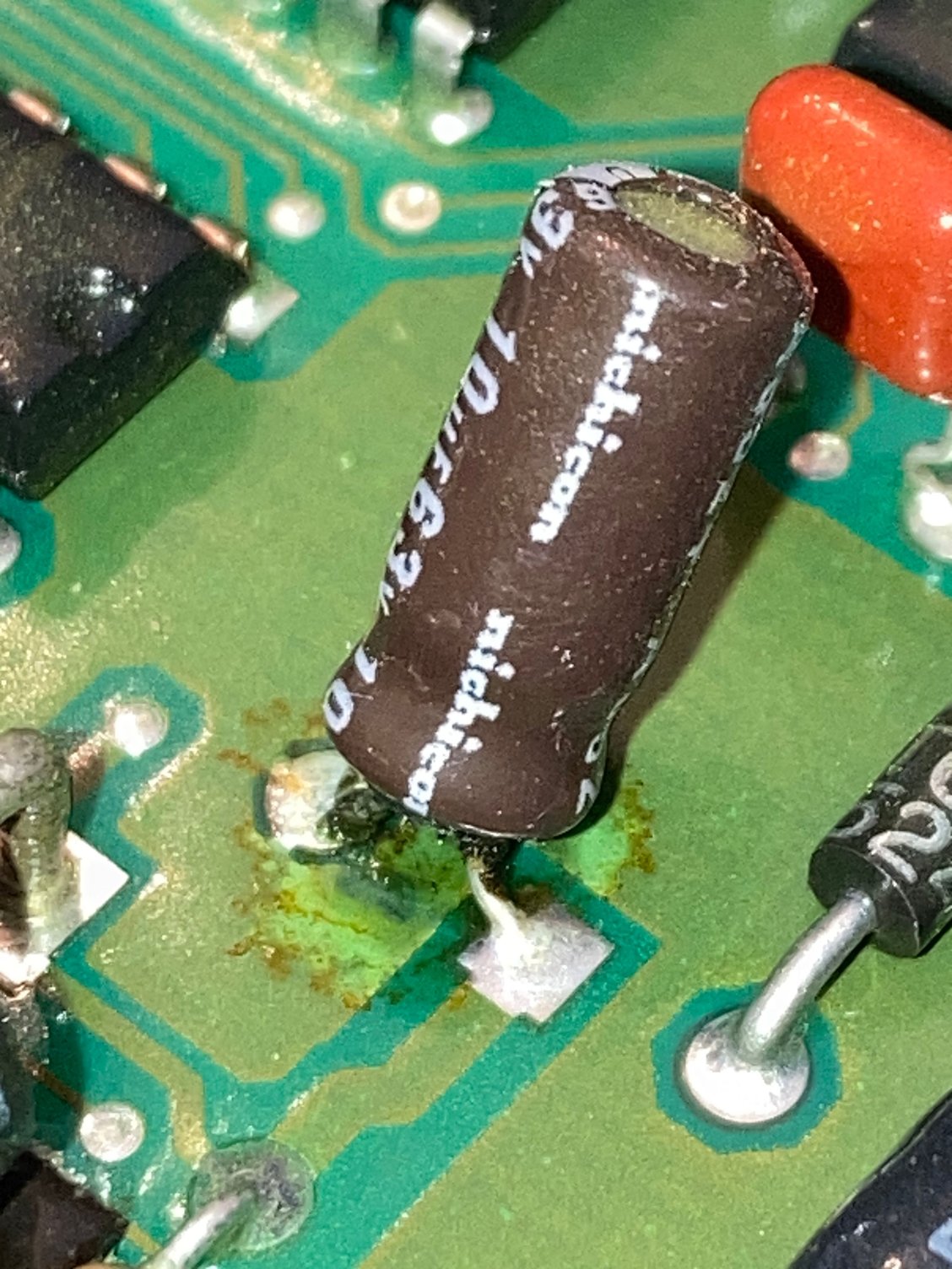

upon a closer inspection of ECM capacitors, one was obviously leaking/ failing. After replacing all three the van runs great with no misfire. I’ve been fighting this thing for so long it’s hard to believe that it’s fixed but I’ve ran it through the paces and all is well.
Ah man. Unfortunately for me after a few miles it came back and seems to be behaving much as it did before =/
