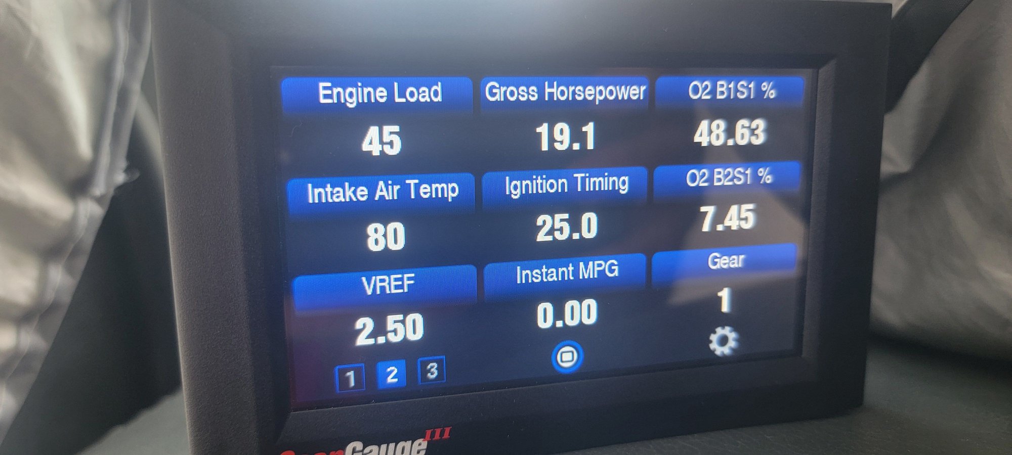

Is there any way you can post the data stream info which would include the fuel trim and oxygen sensor info ?
Should be able to verify suspicions with that info..

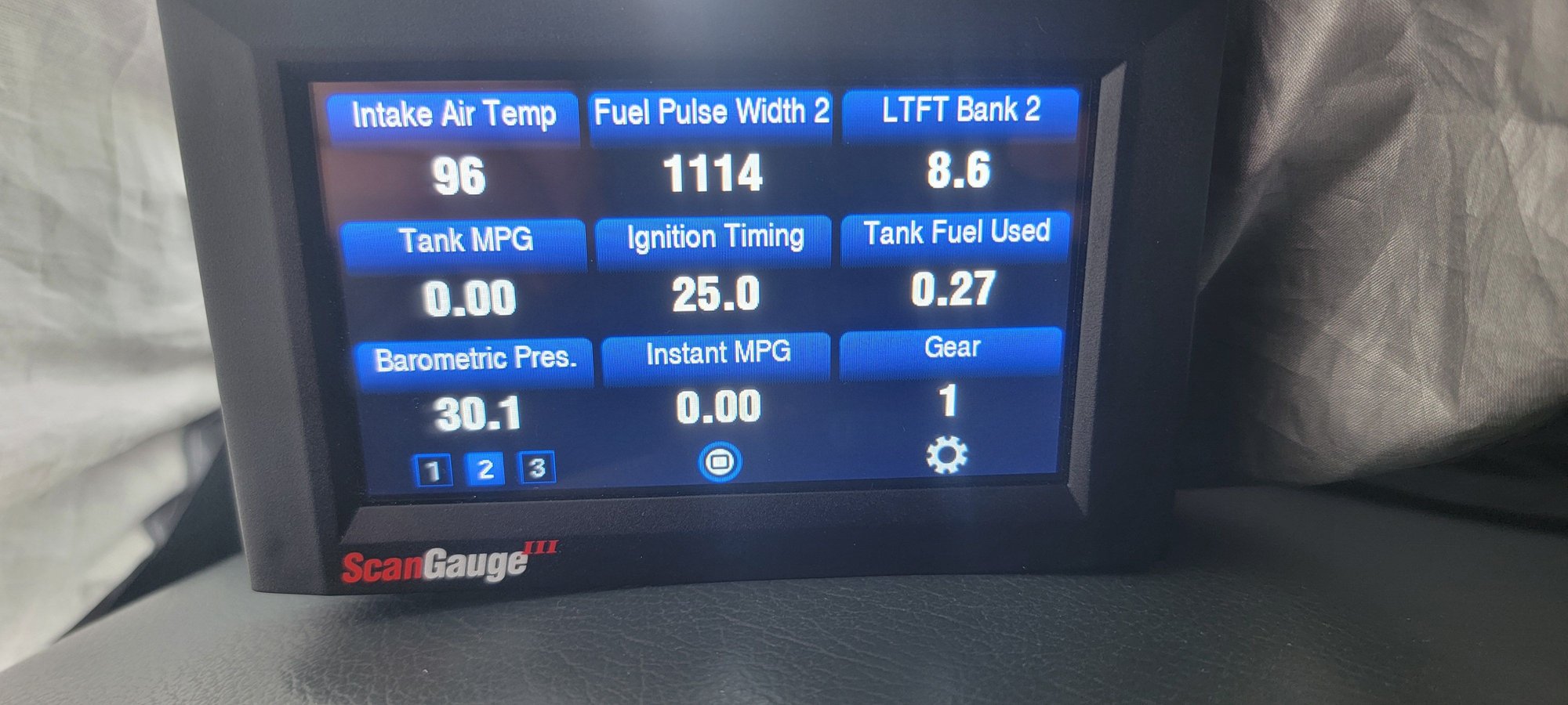

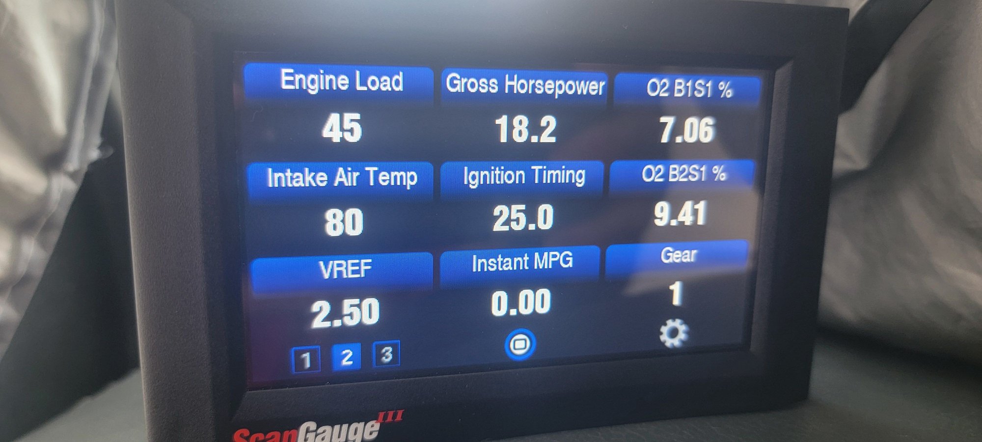

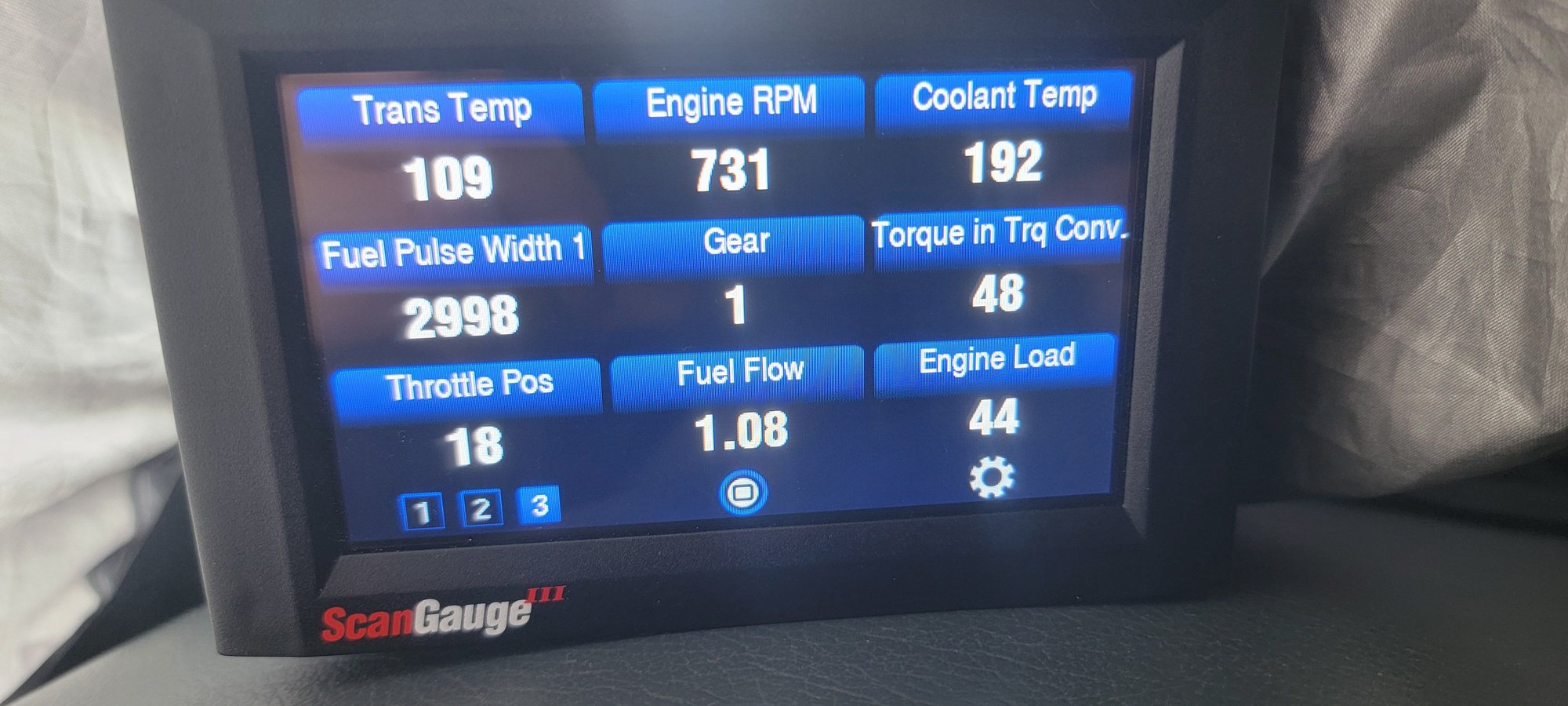

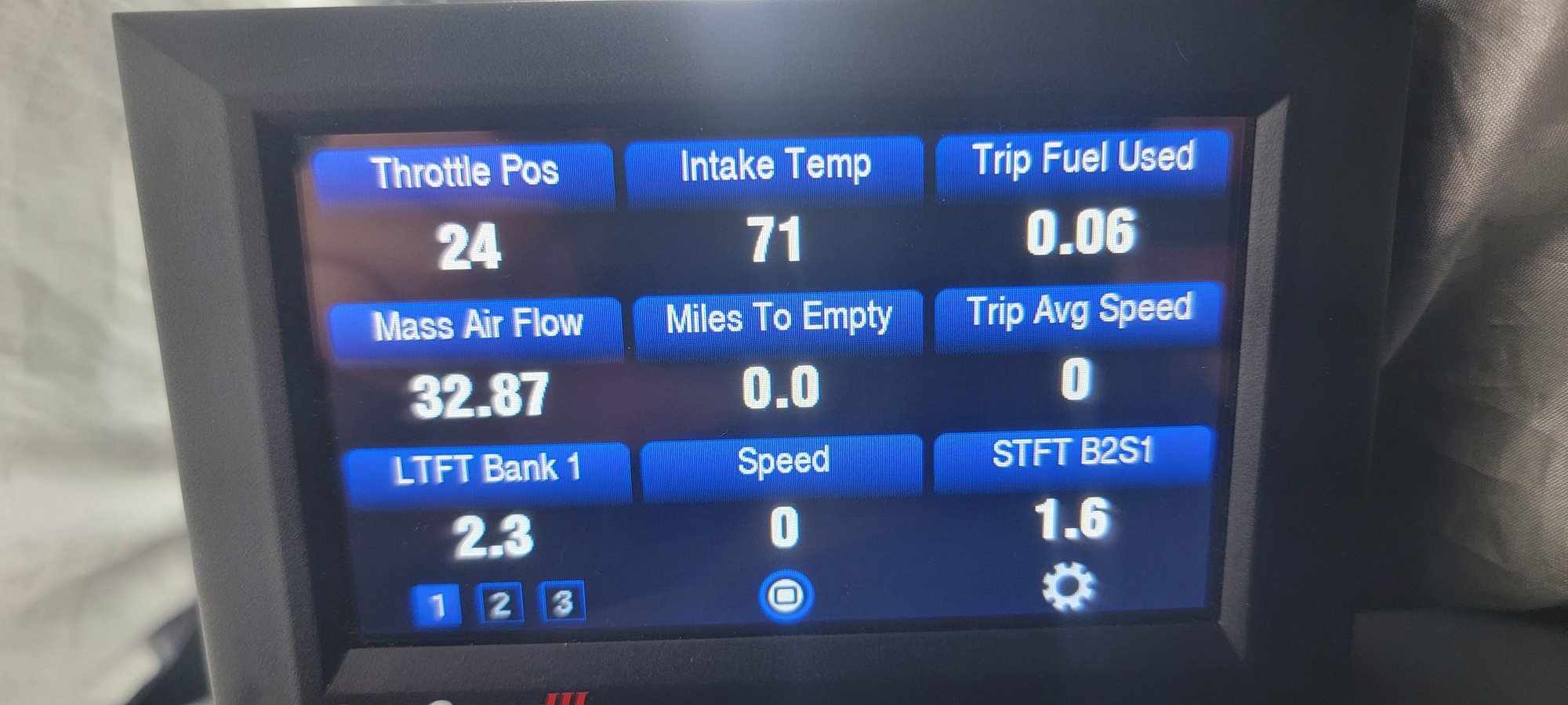

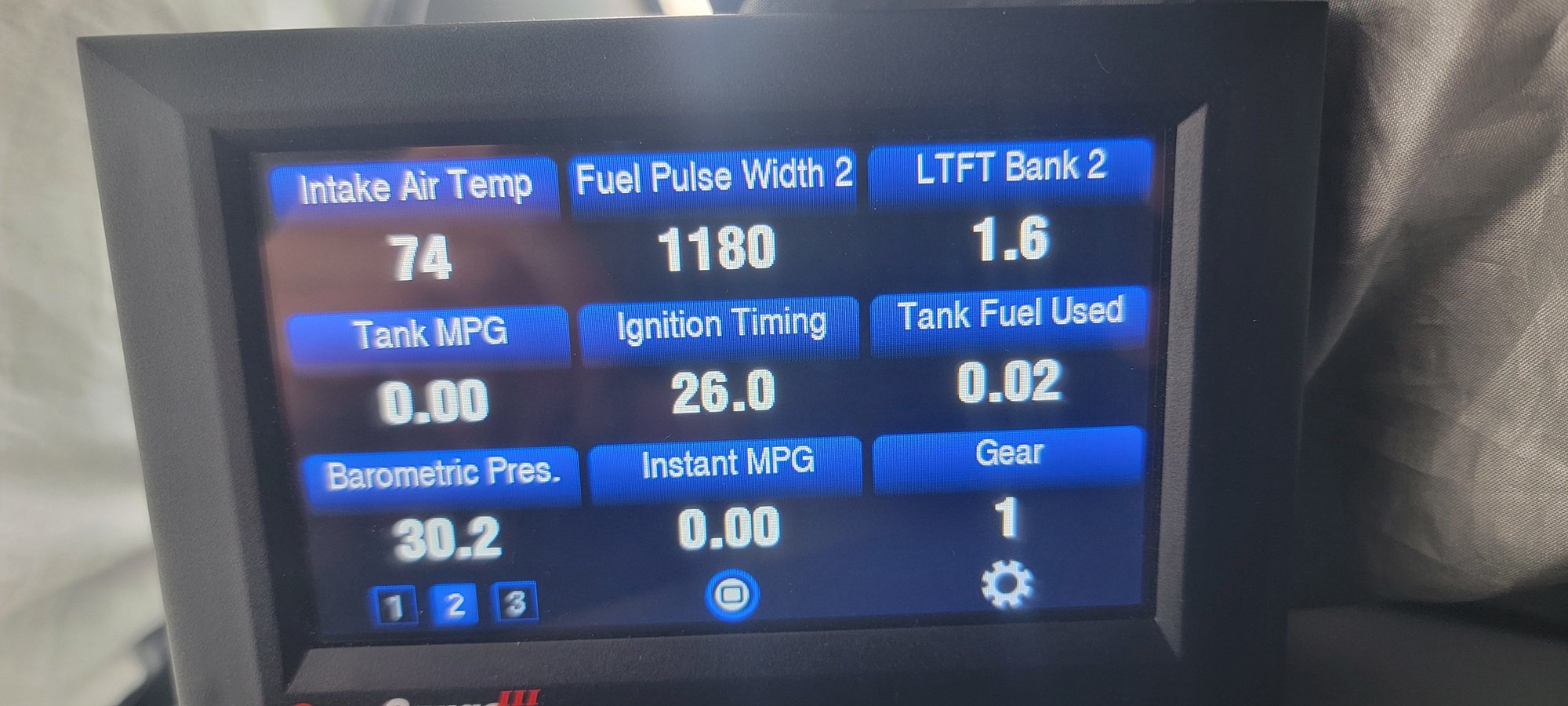

yes, I did sets of 3 screens starting cold in n. Then in D. Then in n higher rpm. Then back in d. Finally I found a fuel flow setting. Noticed it sometimes jumps to 0 for 1 second when I quickly tap on the gas.
Cold n
Cold n
Cold n
Cold n
Cold n
Cold n
Cold d
Cold d
Cold d
Cold d
Cold d
Cold d
Cold n higher rpm
Cold n higher rpm
Cold n higher rpm
Cold n higher rpm
Cold n higher rpm
Cold n higher rpm
Warm d inital tap of throttle. Fuel flow shows 0 at times for 1 second
Warm d
Warm d
Warm d
Warm d
Warm d
Warm d

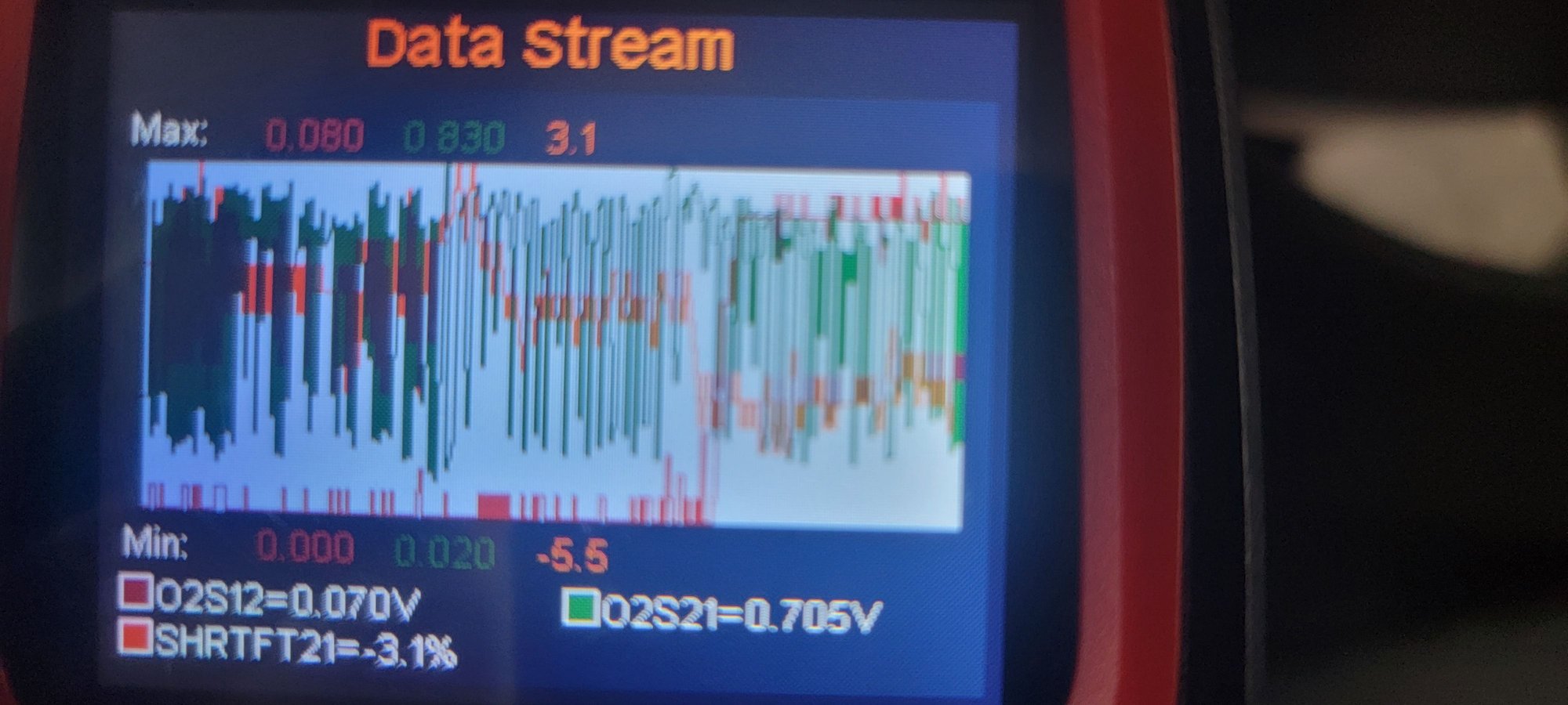

Today I tried new sensor settings. I'm noticing rapidly fluctuating voltages on both 02 sensors while warm from .1 to .7v constantly. Is this normal? Also the live data pict showing first higher rpm, then idle, then in d.
Old May 4, 2025 | 02:29 PM
  #29
Posts: 16,628
Talk about information overload,,,,,,,,,,,,,,,,,,,,,,,,,,,,,,,,,,,,,
Many things caught my eye , that Vref should be 5 volts. Something is pulling that down. One way to find that cause requires removing plugs from the various sensors and watch which sensor is shorted pulling that voltage down.
