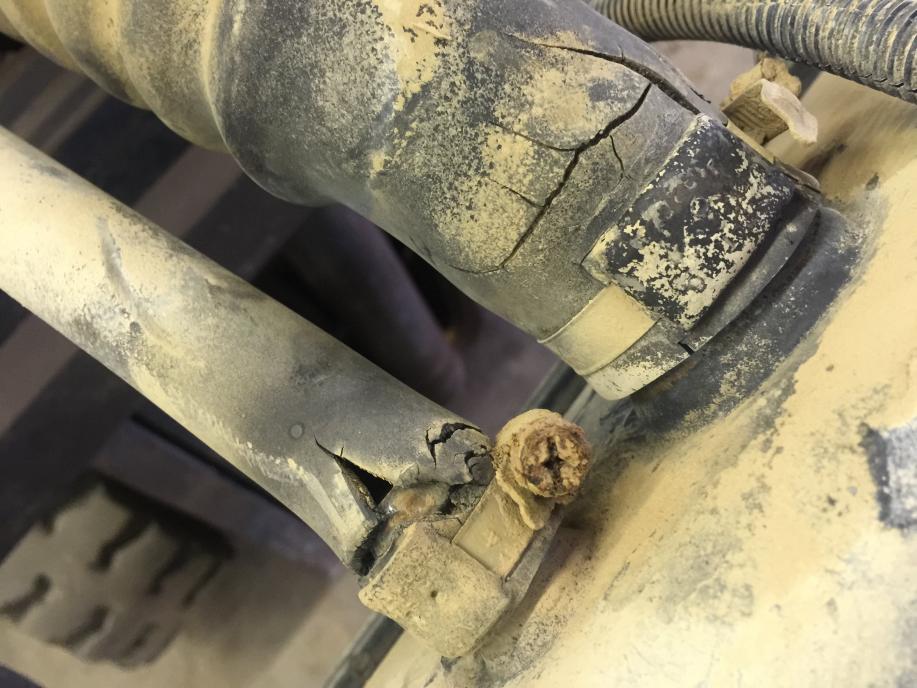

i know where they go, i'm just wondering how that hose off can effect the vehicle,
also found these hoses cracked, most likely the reason my pump failed,

Got it together, had to buy new tank straps, new gas filler tube, fuel pump and gasket for tank, the spin but no start issue is fixed, the sock was dirty on the pump, maybe the pump was still good, but i decided to replace it anyways since it's still original pump..
van has more power, but now something belt driven might need fixed, when i start it it's making bad bearing noise, almost sounded like the air conditioner, will have to check into that now, thanks hanky for the help! without you this forum would be dead,
