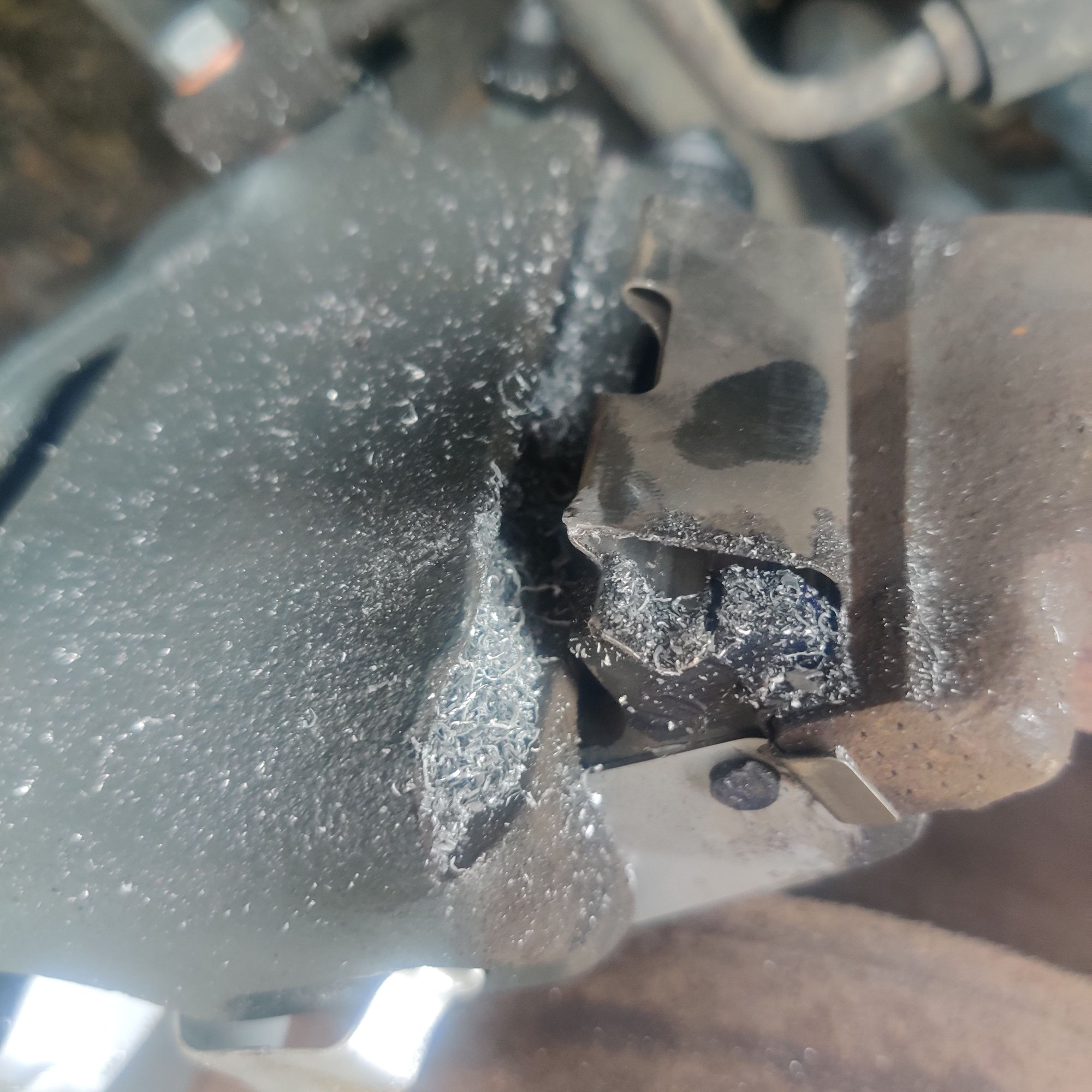

also here is what I found out was scraping, one of the brake pad retainer clips!
arent they the same? I got a pair with each caliper, and a pair with that new brake pads.
they all looked the same to me, but I didn't look close so I dunno if they are exactlyyyyy the same.
so, I got a grindkgn stone and I'm slowly taking off 1/16 to 1/8 inch from the clip that is running against the rim
sheez, pads and calipers in the front took me two days... embarrassing! 😎😉🤣
taking about 1/8 inch off the very tip of that upper retainer clip. and , cleaning out all the shavings

understood about the rotors. they had no lip or grooves (very early failure of driver caliper)
Im gonna carefully grind down the pad clips so I can take it somewhere and have someone inspect my work.
are the clips upper and lower specific? or pad or rotor specific?
they all looked the same.
Old May 28, 2024 | 07:57 AM
You should not need to alter the clips in any way. What you should do is clean the rust that formed on the caliper bracket that the stainless steel clips , clip onto.
Old May 29, 2024 | 02:56 AM
BoughtAVan's Avatar
Joined: May 2024
Posts: 8
From: Virginia, USA
hanky! thanks for your help.
ok I will look at that again.
question...what will that do? the stainless clips just snap on the caliper bracket. they fit pretty snug. is there something I'm missing ?
honest, I should not have thrown out my old clips, because then I could size them up and see what the issue is....( if I used the wrong clips in the wrong positions, or if they were just built to different tolerances )
I may just go to Ford direct and buy some new clips and be done with it
Al
