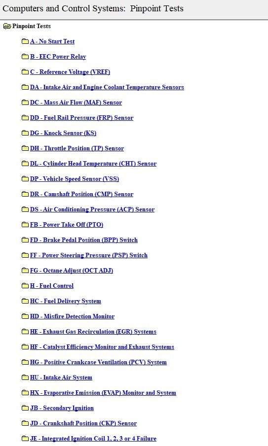

Pinpoint test index page shown above, Pinpoint-Test-All.pdf attached below.
When you say hesitation, it's usually air related so I randomly picked out just pinpoint DC and HU, easier to go over than the huge pdf.
Among air, fuel and ignition, air has the highest possibility on hesitation, if you can obtain the LTFT value that can narrow things down.
Just run a bottle of techron is useless, you need to deep clean it for the first time, then you run techron every 2 fillups. To deep clean you use Berryman 2611. Then you can run Berryman 2616 and use Berryman 0116 just like Techron. You are highly urged to run 2611 first, whether or not you have very high LTFT, a sign of vacuum leak.
