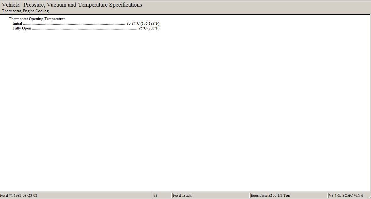

Above diagram shows the OE spec (176 to 183 degree)
The tstat choices out there are in 160 to 196 range. I asked you which tstat just want to make sure your new and the old tstat are not colder than OE spec. If the temperature difference is 10 or higher on old and new tstat, that could trigger the check engine light and a CEL reset should clear that permanently. Your Motorcraft RT1254 is 190, so your 190 tstat opens a little late. When it opens late your engine should reach operating temperature sooner than OE spec. Not that picking Motorcraft RT1254 is out of OE spec, it depends on the location and driving style. It's better to open little late than too soon. For those who don't like warm up their cars in the morning (especially in cold weather location), they should get the highest temp (196) and never go lower than OE spec.
So your tstat, if it opens at 190 (fully open add another 20 (190+20=210)), and your temp gauge doesn't move upward at all in 10 minutes, then something is wrong. Check Tstat-Test.pdf below if needed. When your van reaches operating temperature during driving, it really doesn't matter as it will likely stay at full open anyway.
