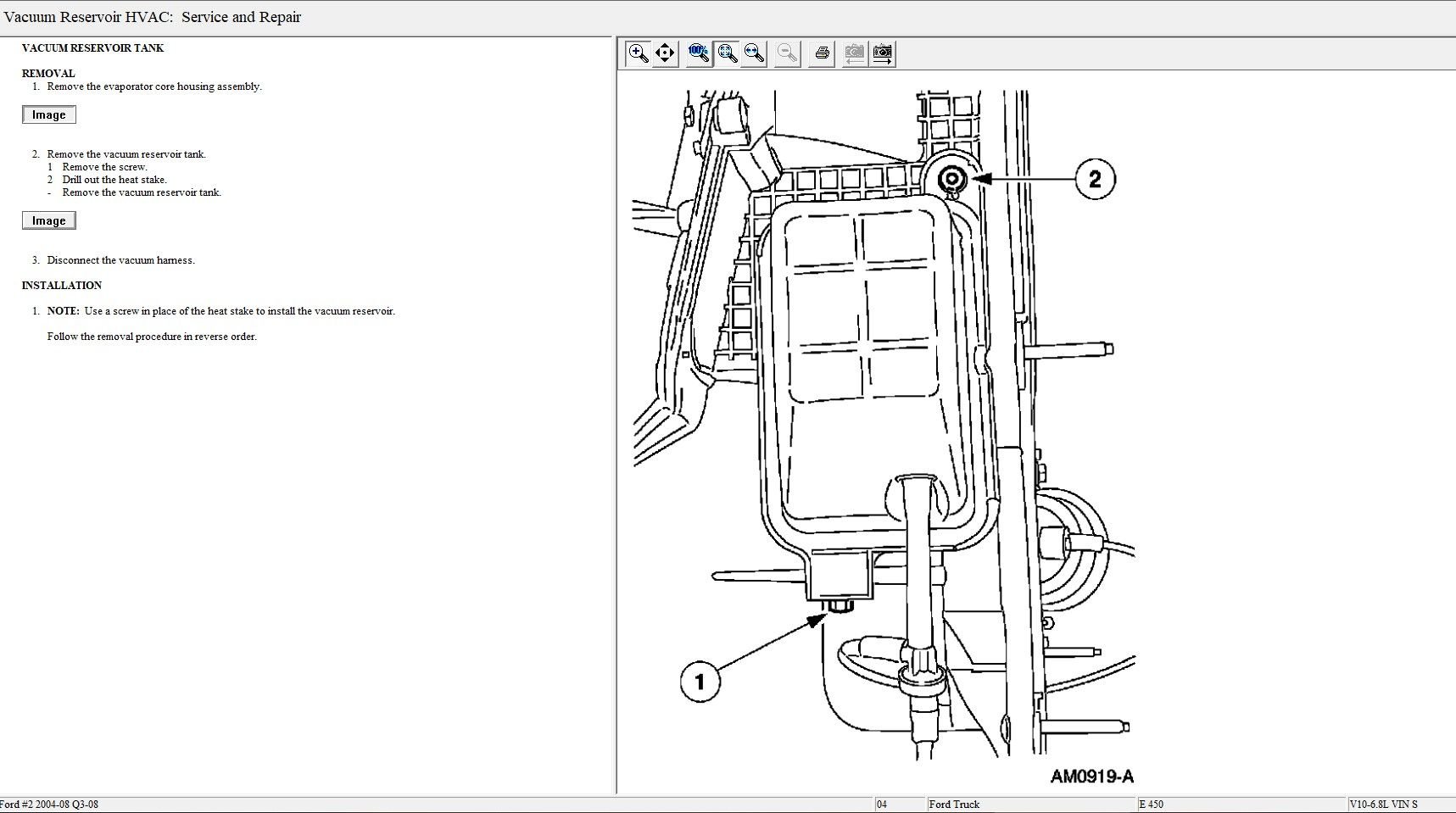

First thing check the vacuum reservoir tank and the check valve.

Don't know, can't find the location.
How it looks: More Information for DORMAN 47995 (rockauto.com)
And the check valve: More Information for DORMAN 47150 (rockauto.com)

I have repaired this twice on my 06 E150. It is easier to abandon the old vacuum res and install a new one and check valve. Getting to the old one is impossible !

Thanks, everyone. I have the parts ordered. This looks like an easy fix. FWIW I liked this video best.

Follow up: I ended up routing the vacuum from the engine through the fender because I already had a wire in the path the needed to come out. So it was easy. I attached the reservoir to the bolt that is up by the dog house inside the cab because the location by the battery has a high current fuse for the motor home that blocks that location. All seems good. I took a 9 hour road trip and all worked great.
