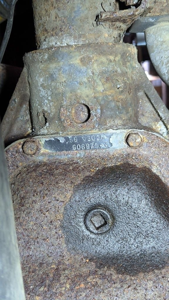

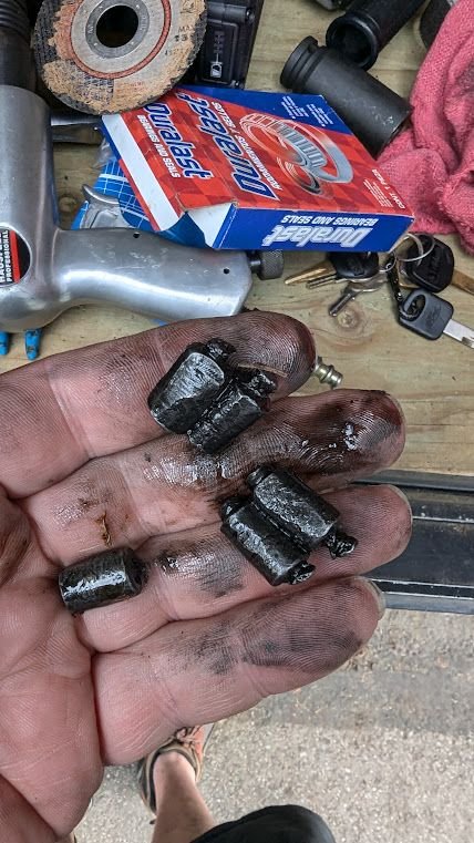

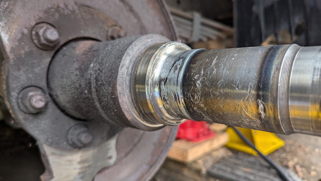

The back of my RV had a little trouble during a trip, and sadly, when the the bearing let loose it pretty much trashed the end of the axle carrier. Photos for those with an iron stomach for such things. haha. I grabbed the tag off the housing and this appears to be a Dana 70 with 4.56 gears. 4.56 seems to be semi-unique to RV versions of this setup in the E-450SD line. Could someone help me identify what years were the same for this rear end? To the best of my Googling, it looks to be 99 - 2007 and only for E-450SD. The F-450 appears to look different as well with slightly different perches. This will all help me with my yard search for a replacement unit.

Ok, so the door code says it's axle code 83 which is listed as "4.30 F-350" which is clearly wrong as the chassis is not a F-350. And the tag on the diff clearly says it's 4.56. This crap drives me nuts.

I am by no means an RV person or expert, but I do know what causes failures like this and if it is common as you say , what is wrong with this picture ?
Lack of proper maintenance, overloading, poor quality parts wheel seal leakage all can cause this problem.
Which from your perspective might have contributed to this result? None of this helps find an axle assy, but the answers to some of those questions will help a lot.
