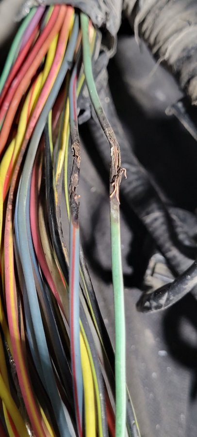

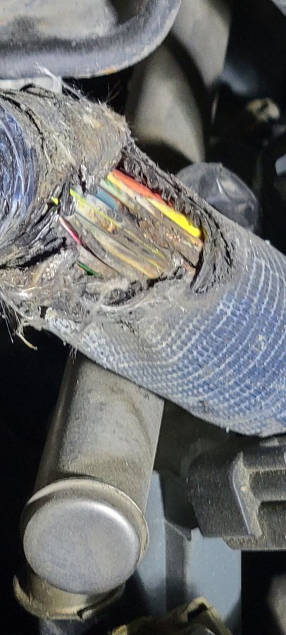

I apologize for not getting that information that was asked for. Got to busy and the van sat. But after taking time away I decided I'm tearing the harness out and here is what I found. Harness was laying across the EGR pipe and burned into 2 wires. The green and white wire controls coil #1 which caused the miss fire I was feeling because the coil was stuck on from grounding out. 2nd wire was the blue and red one which was the maf output wire which for obvious reasons sent the computer into a spiral of random bad information. Runs great again and I guess got a lots of new parts to run for a long time yet. Thank you guys for your help.

The problem you found is somewhat common to those years and models.
Thank you for the update.
