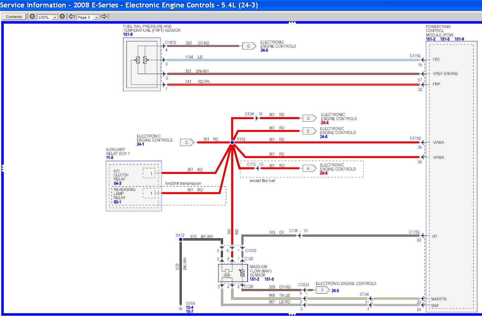

Here are the Function description, troubleshooting chart (starting on page 4 of the .doc) and the wiring diagram. I guessed 5.4L but the wiring for the sensor of interest is the same for the 4.6.
Hope this helps
