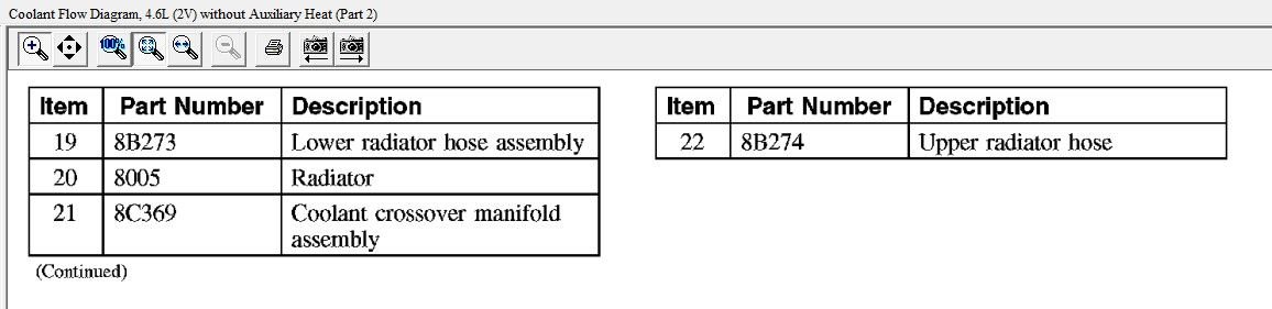

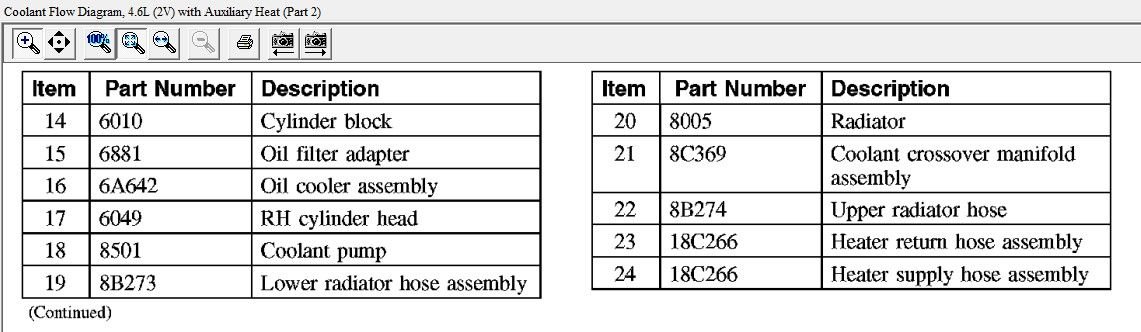

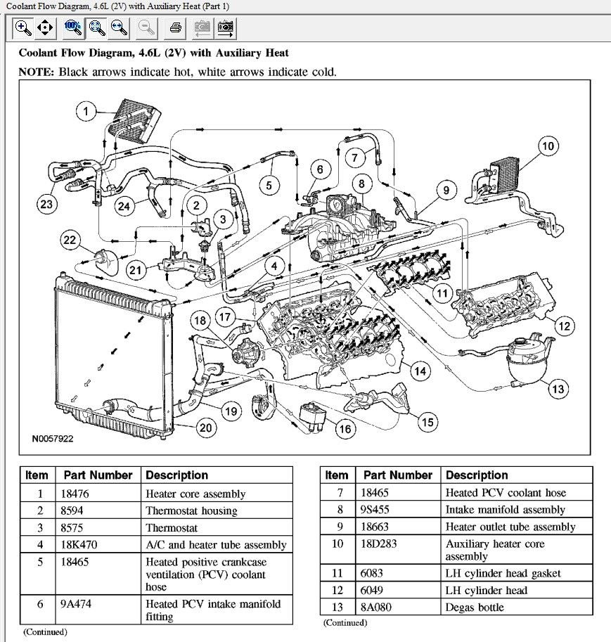

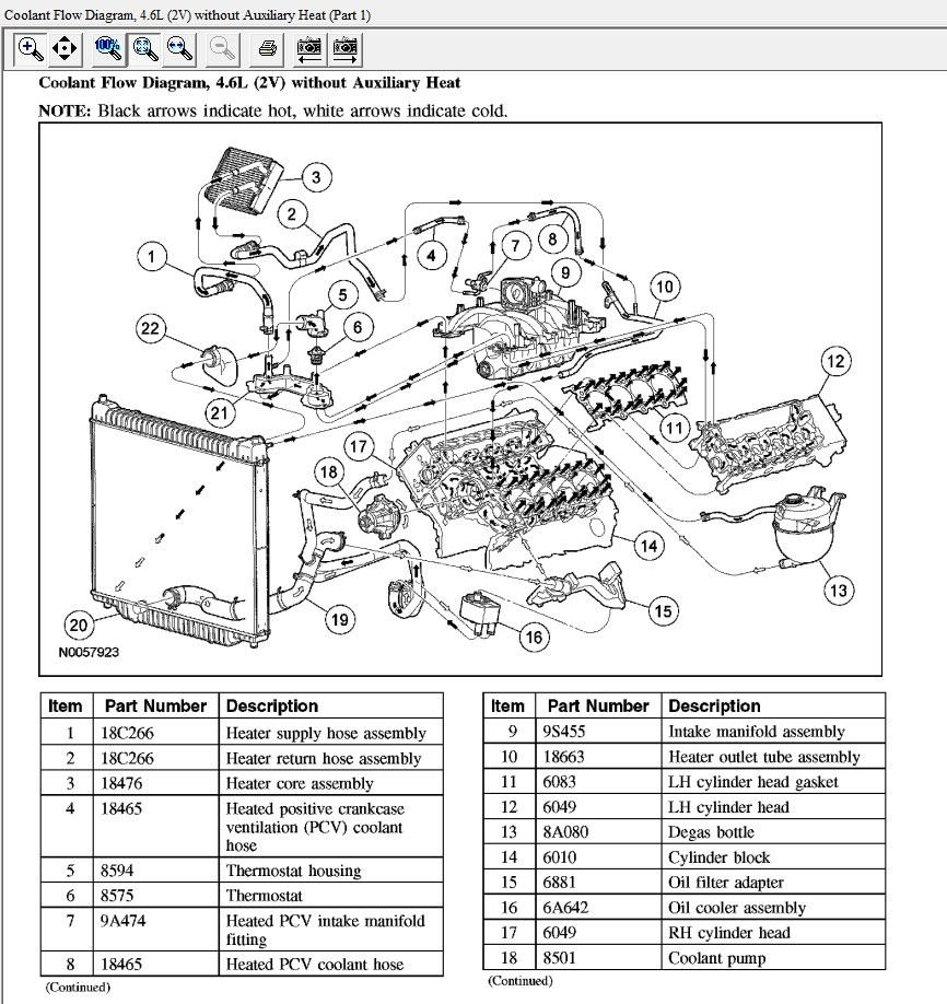

Above diagrams are for 07 E250 4.6L, if you still can't locate it please provide more pics.
