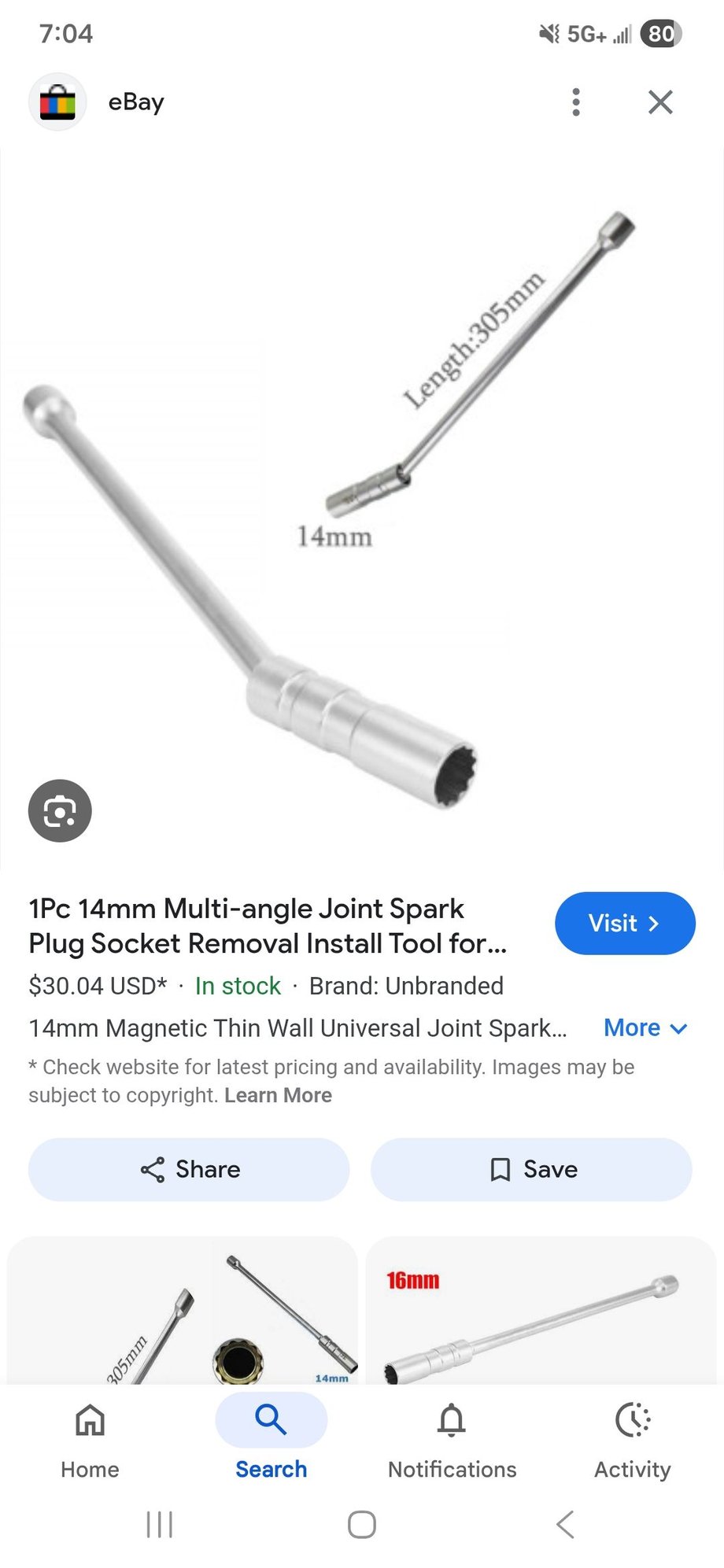

I stopped using detachable plug sockets sevetal years ago. See picture. Using this type allows access without miving fuel rails.
On my E150, I remove the front seats to provide better access. Always soak the plug wells with pb blaster or similar before trying to remove the plugs
