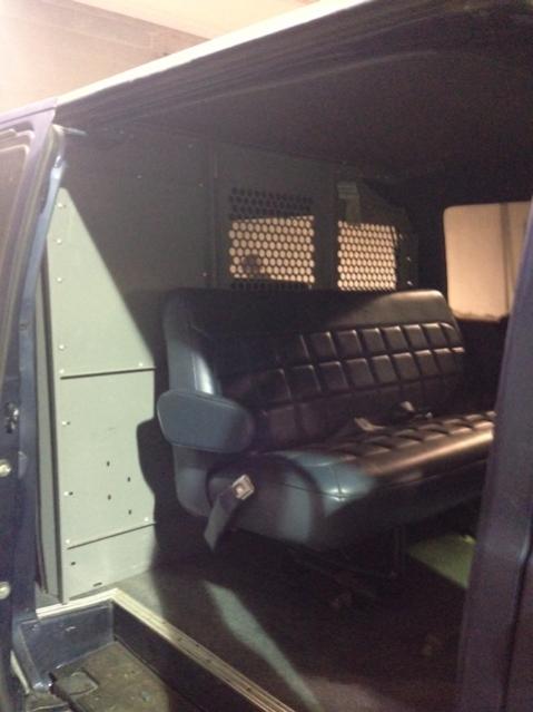

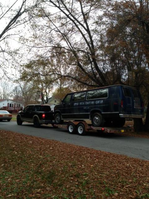

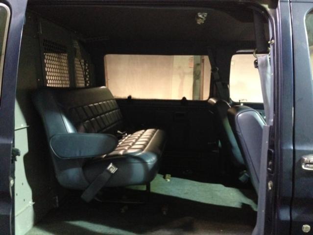

Here are a couple pics of the old beast, my plan is to use it for hauling my motorcycles to the races and camping in. When i loaded it on that trailer i could not believe how heavy that van was, it literally lifted the back of my truck 3 feet off the ground as we rolled it on to the trailer . Im getting ready to paint it and it should look a whole lot better after that, im just going back with the original color for simplicity. The interior of the van is spotless head liner, doop pannels, carpets, driver seat, passenger seat all 4 rows of back seats are perfect, so all im going to do to the interior is take out 3 of the four rows of seats, install a wall then move one rear seat back against the wall as i have mocked up in the pic and i put 3 bikes behind wall and they fit perfectly. Im really excited to use this van, ive always wanted one for this reason.

Looks like a nice project, good job on the partition
