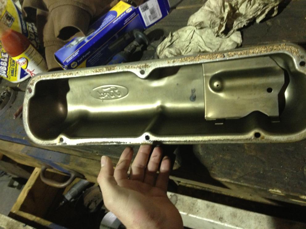

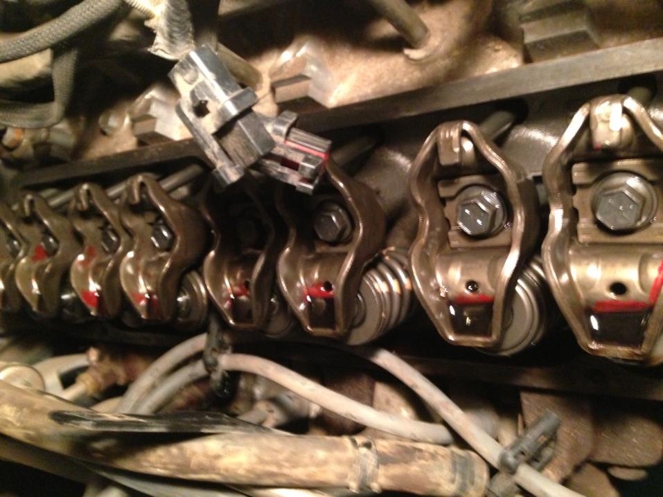

Quick update,
I havnt had a ton of time to work on her lately between my job 9-5 job and my side business buying, fixing, and selling euorpean and Japanese cars and motorcycles. Anyway now that I am waiting on parts for the two BMW im working on (540i and 325i) I finally had time to work on it some more all new injectors are in they are OEM replacements with some sort of upgraded nozzle for better fuel mielage......so they say, new valve cover gaskets are in, finally got to the two front spark plugs on the passenger side that were such a pain in the *** to reach, intake plenium and new gasket is on, now all that is left is hooking all the emissions hoses and vaccum lines and she should be ready to fire up. I also have lined up one of the fold flat bench seats that turns into a bed from a coversion van to replace my bench seat infront of my dividing wall so that i have a place to sleep in this thing, after a very intense cleaning/disinfecting I will be installing it.
Here are a couple pics of the valve cover and underneath it, i did not clean these this is how clean they are........which was a pleasnt suprise compared to underneath the valve covers of the high mielage cars i usually buy.
Attached Thumbnails 91 e250 won't start been sitting since 1996-van-valve-cover.jpg   91 e250 won't start been sitting since 1996-van-valves.jpg
Old Dec 5, 2013 | 10:09 AM
  #20
I have found that it was much easier to remove the battery and the four 8mm head bolts that hold the air filter assy when changing those 2 R/S plugs. Since you are already into changing valve cover gaskets you probably have already done that.
