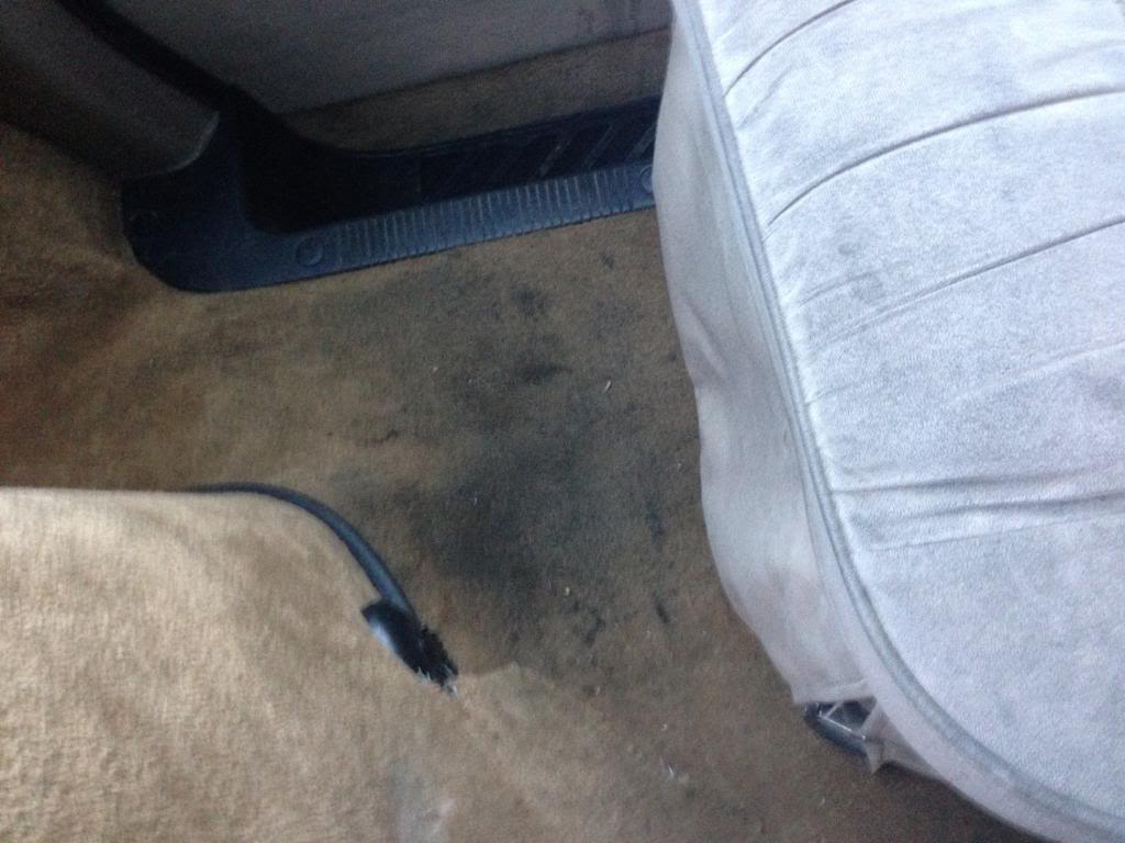

The van is not in the best condition since the interior smelled HORRIBLE, and all the seats are falling apart.
