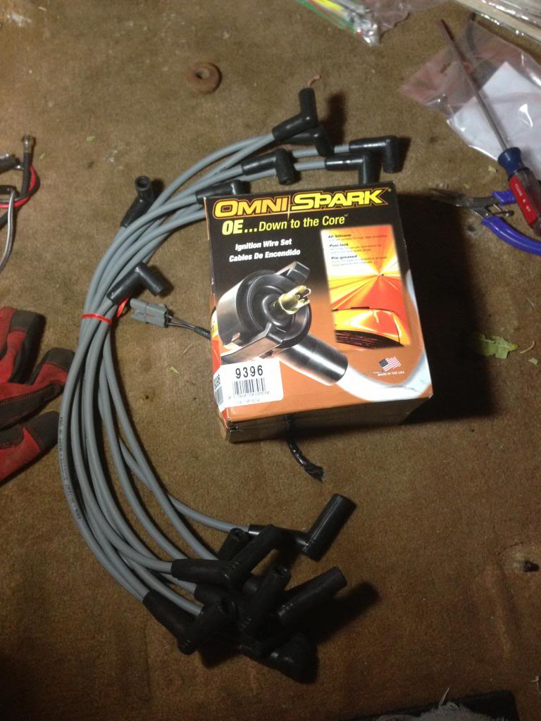

Hey Hanky,
I changed out my spark plug wires today and my car is running a lot smoother. I also drove my van around last night for about 15-20 minutes and the check engine light no longer came back on!
