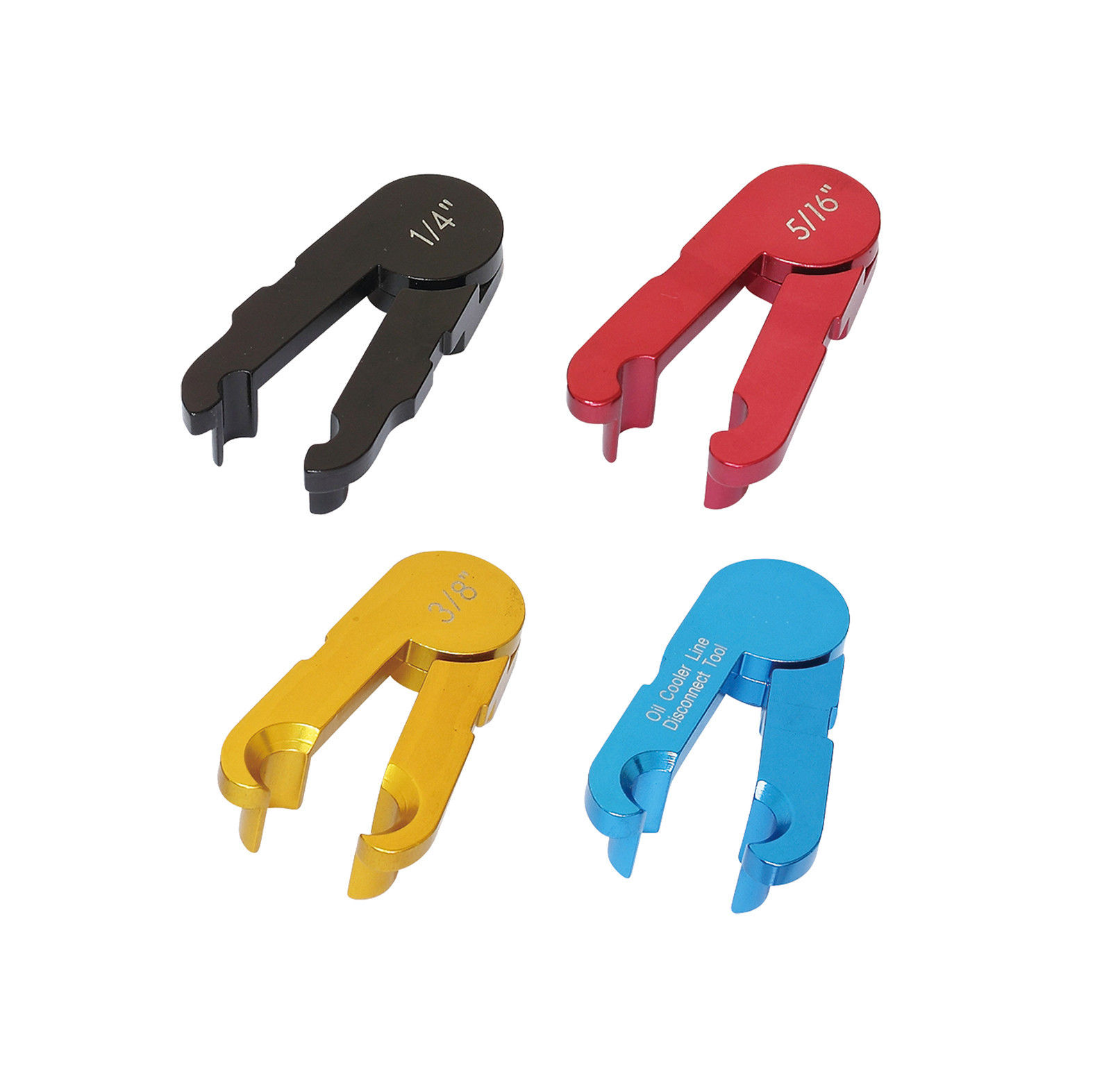

The quick disconnects couplings were a good collection point for dirt/debris. Spraying penetrant, ,,good!,, blowing out the connectors with compressed air and more spray, even better.
The inner spring clip,,, really wont matter if slightly bent since the tool pushes the legs out of the way for the fuel lines crimped rib to pass by. Unless the clip is twisted/destroyed or heavy rusted,,, what helps is to 'keep' pressure against the release "tool to connector" and 'gently' rotate the line head and tool as you pull back. A rocking/twisting motion helps on some. A inexpensive tool like the ones pictured work much better then the nylon (although nylon do ok) since some of the cheaper nylon/plastic release tools may not extend into the connector well enough, or be a more precise solid slip fit to gain a full release.
