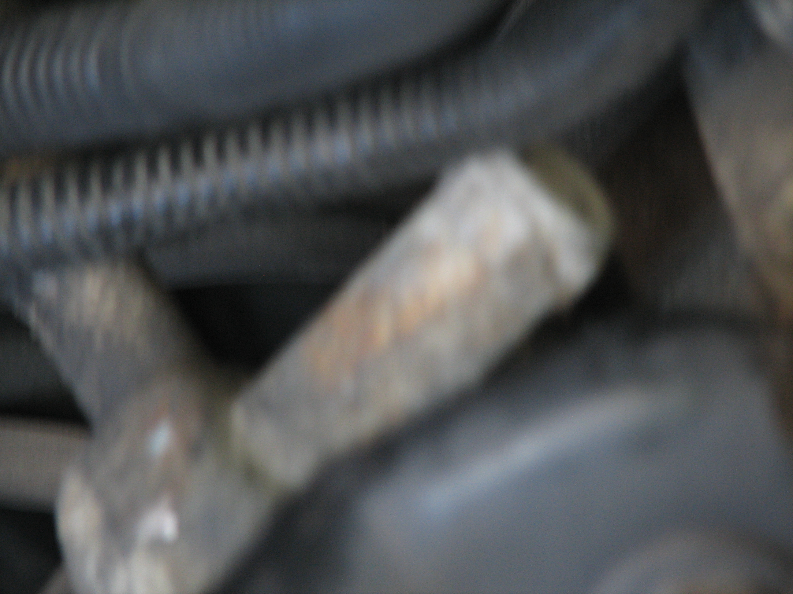

Only thing I can find on the bigger line side and this is on the compressor. If this is it, Ihave no idea how they charged it.

That's the high pressure relief valve..
