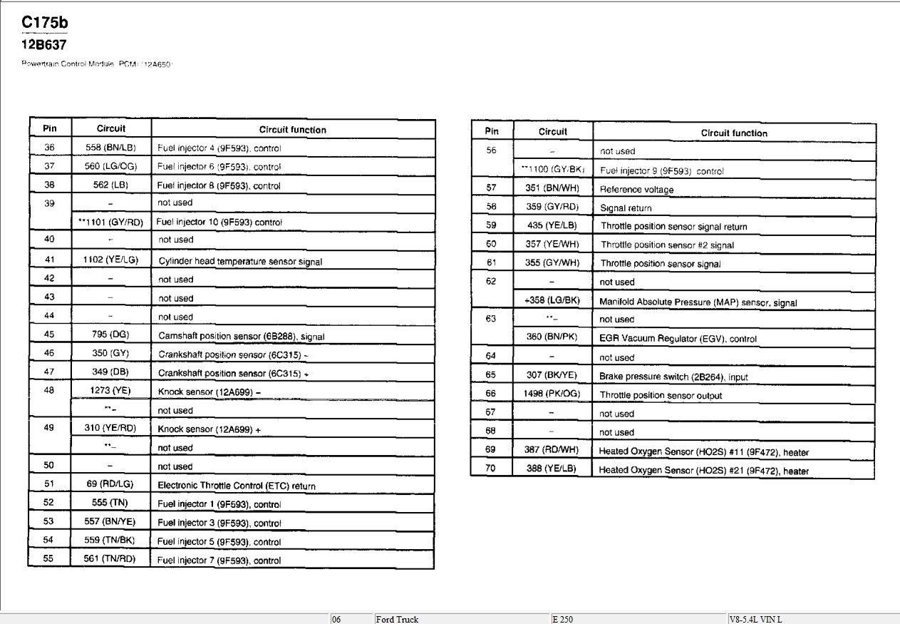

The check gauge refers to just one gauge, your coolant temp.
Your van doesn't have a ECT but CHT check below:

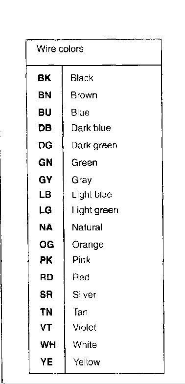

1) CHT sensor itself can't go bad, so check the connection between your CHT and PCM's reference voltage: (C1047 -> C1046 -> C175B's terminal 41, yellow/light green wire) and return signal: (C1047 -> C1046 -> C175B's terminal 58, gray/red wire)

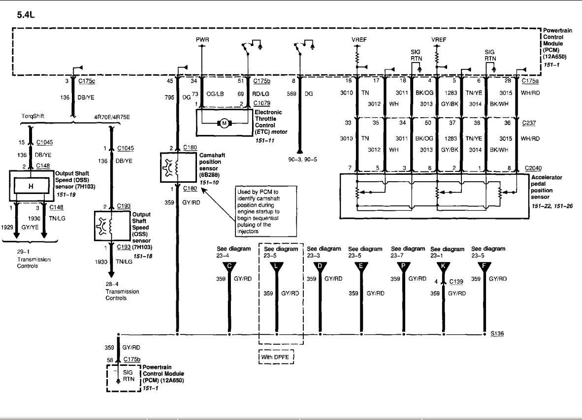

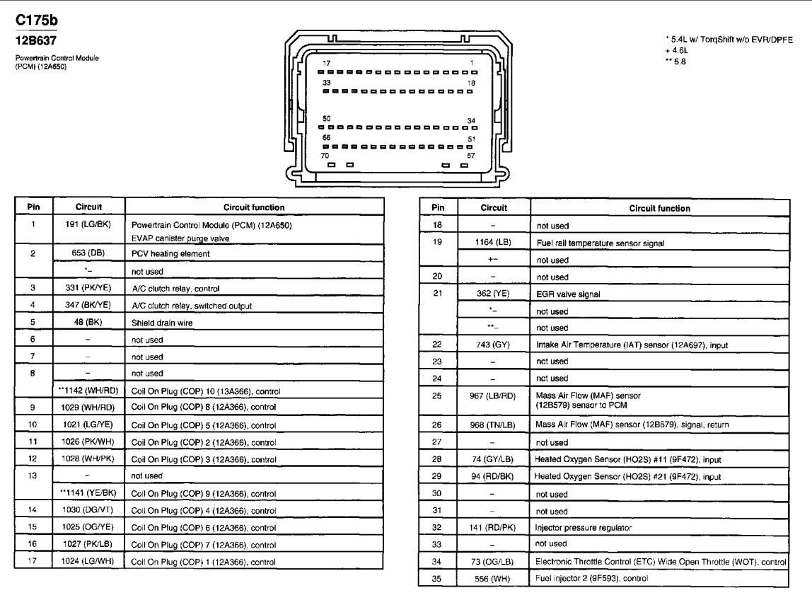

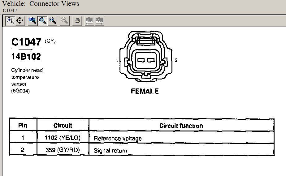

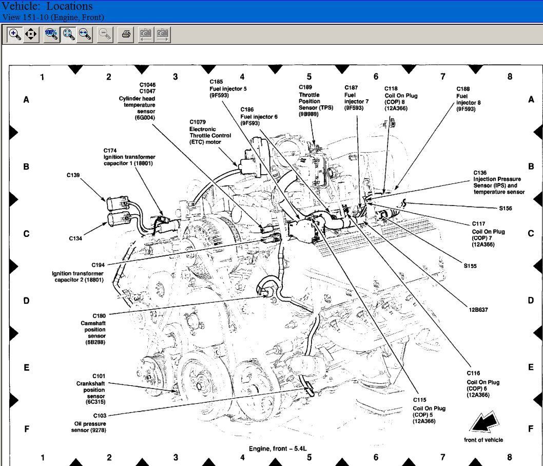

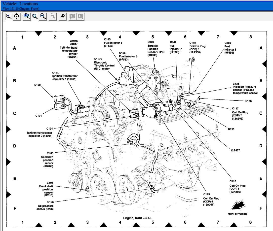

Locate C175b above, unplug the connector and find terminal 41 and 58. Unplug the connector on your CHT there is only 2 terminals. Test continuity between C175b-41 and C1047-1 (yellow/light green wire) and between 175b-58 and C1047-2 (gray/red wire), just to make sure your no break on the 2 wires.

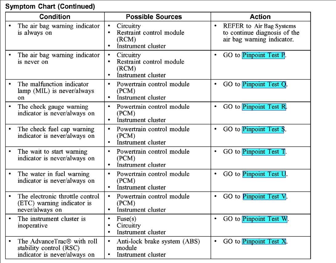

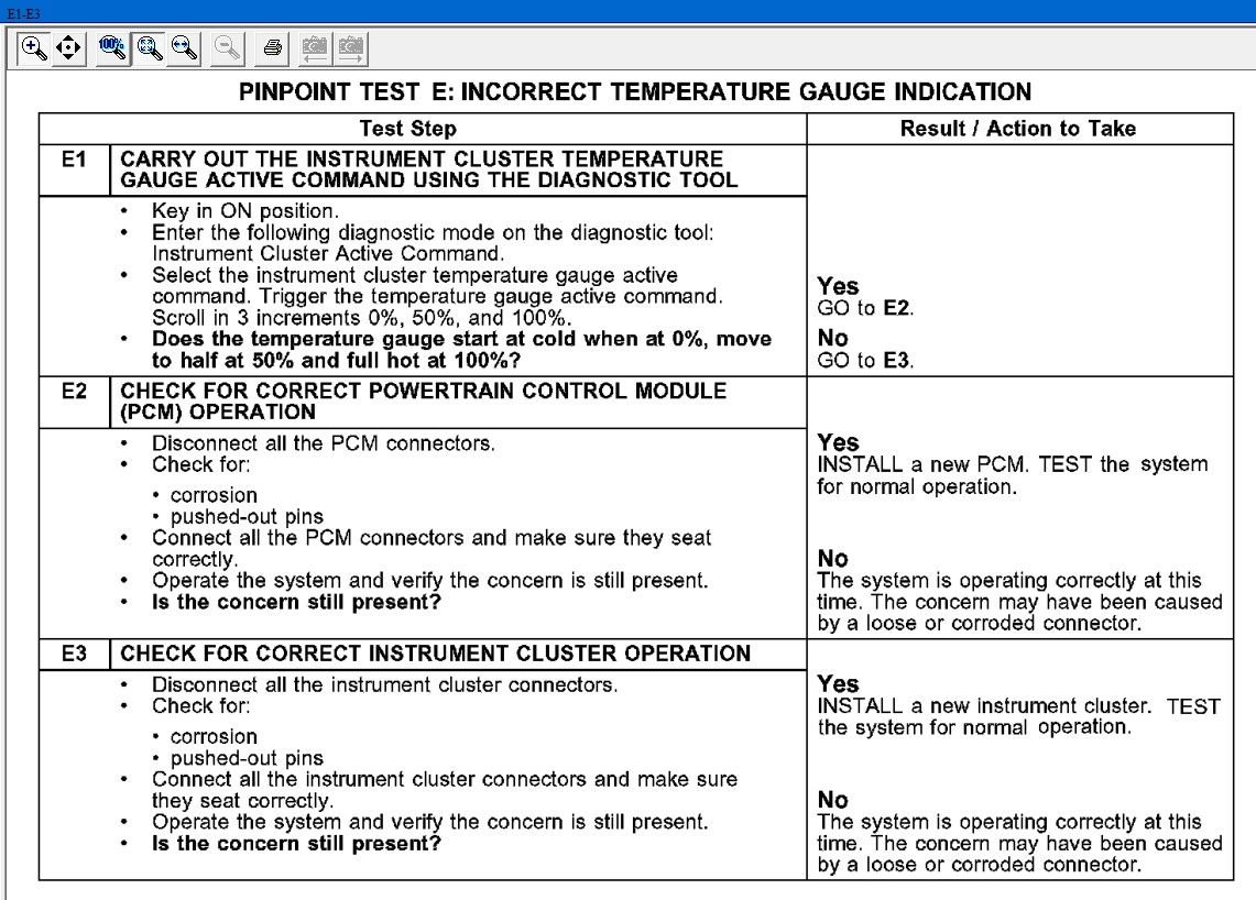

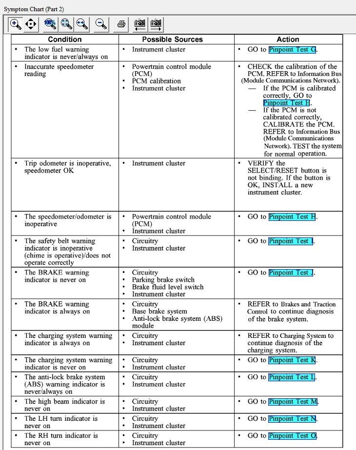

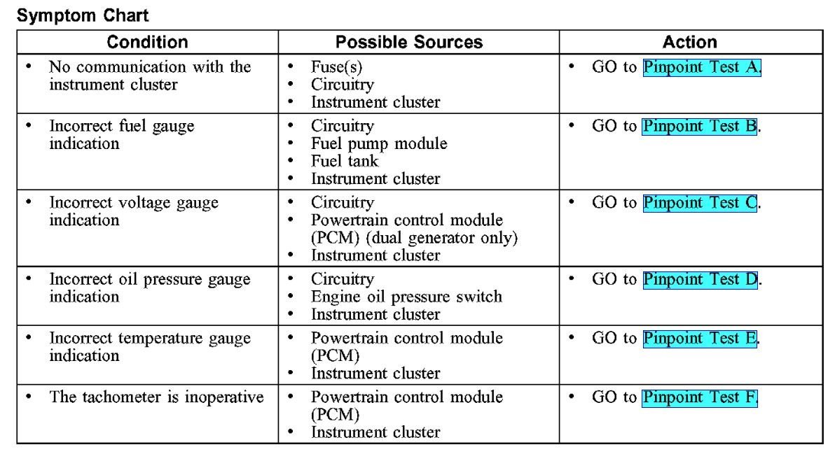

Pinpoint Test list below:
And Pinpoint E shown below:

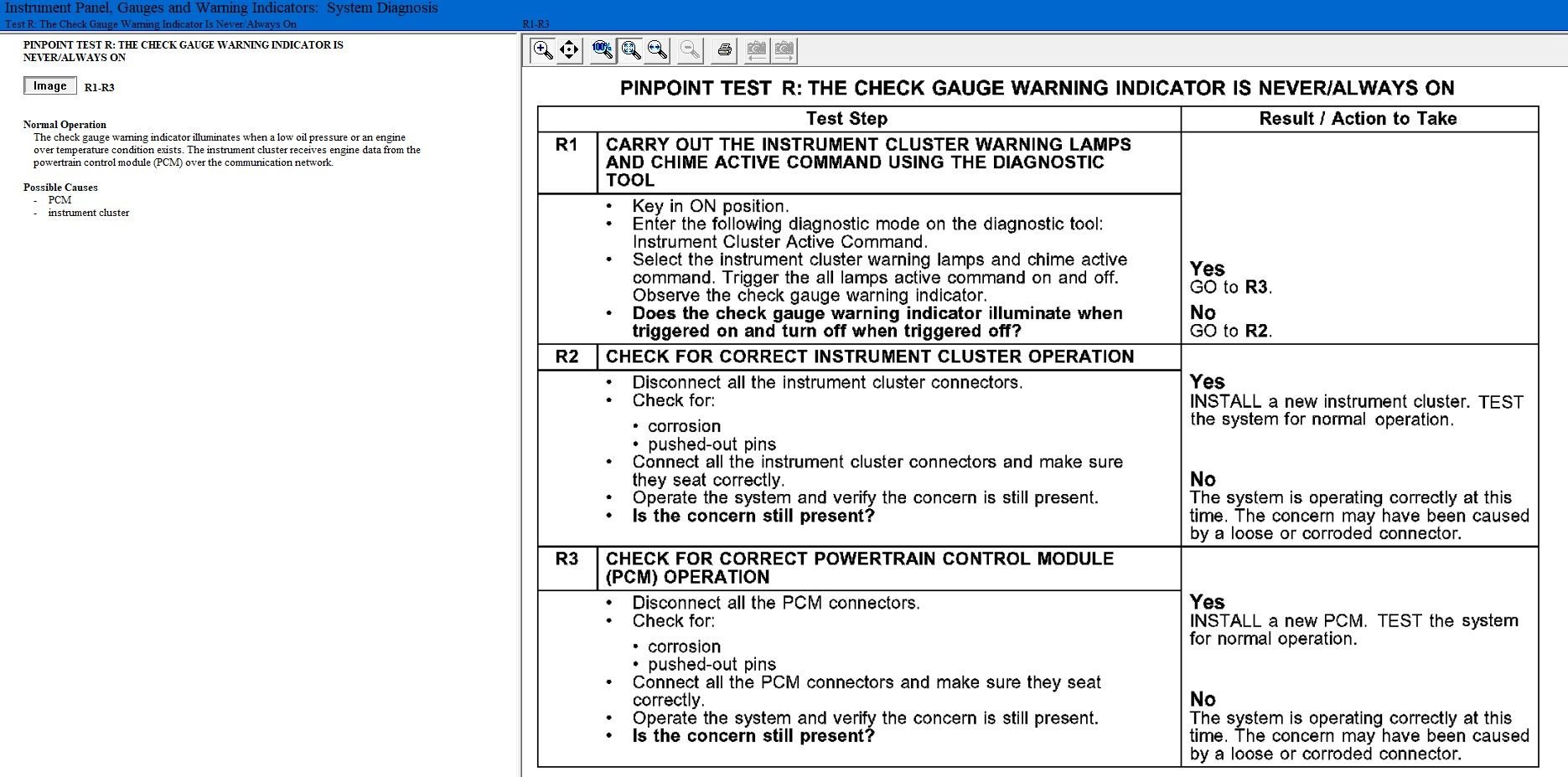

Pinpoint R shown below:

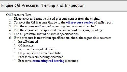

It mentions about possible low oil pressure as well, so check your dipstick and top it off accordingly. Pinpoint-D.pdf below.
Note yours is NOT always or never on, so you probably don't need to go thru pinpoint R.

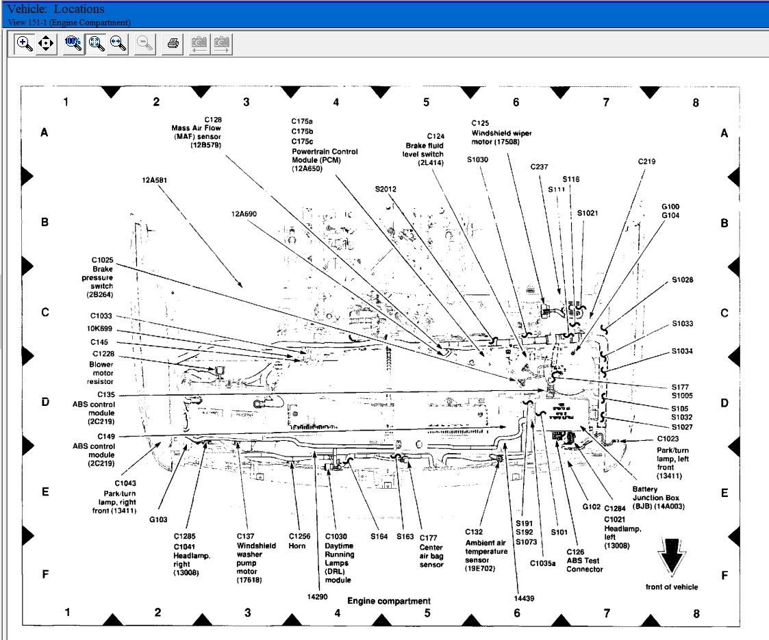

Locate C103 above.
