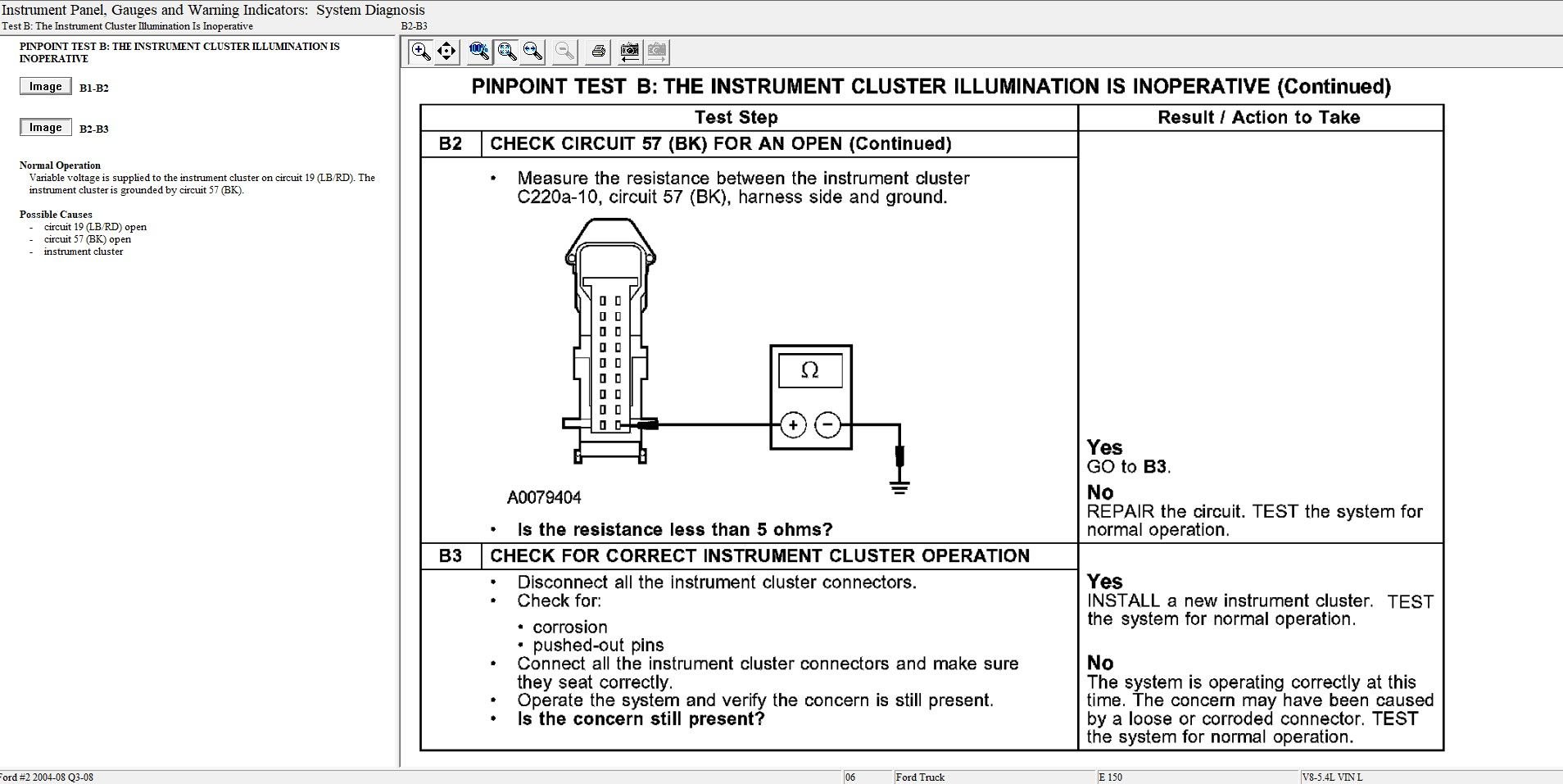

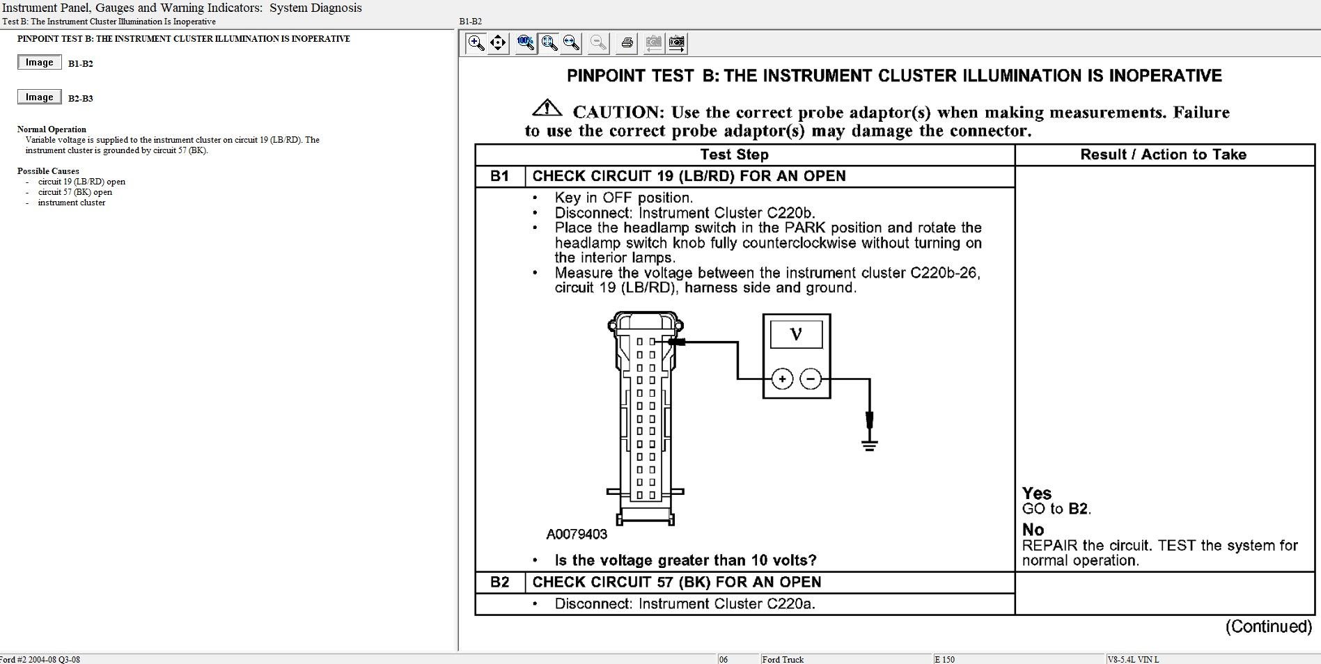

Old Sep 23, 2024 | 11:16 PM
Check new pdf below.

Appreciate it, but it does me no good
Old Sep 24, 2024 | 11:45 AM
You insisted it was a problem with the relay, so look at 60-4 then bypass the relay and test. First thing test all associated fuses. You can even borrow a relay from another device within your own van.
