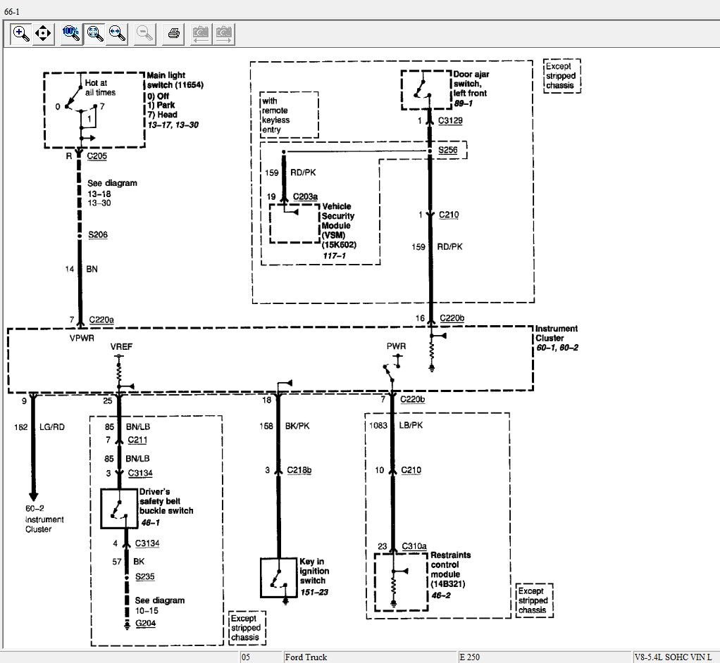

Old Dec 16, 2025 | 07:11 PM
Chime.pdf index page shown above.
Locate C218b below.

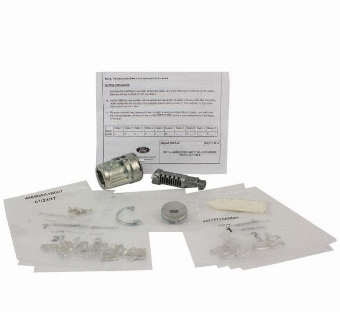

It's called ignition lock cylinder, not ignition switch, that's having contact to the steering wheel column when your key is out.
Please note that on steering wheel column all the metal parts are grounded to chassis. When key is inserted there is a linkage (could be a wire or a metal pin on 2019) that's in contact and touching the steering wheel column to get ground signal. When key is pulled the linkage should be broken but that's not the case on yours and it's the ground signal that triggers the chime.
You will need to remove the steering column shrouds (upper and lower) to get to that linkage to see why it's touching your steering wheel column when key is pulled. While you are at it use "dry lube" (always safer) to lubricate between your ignition lock cylinder. If you found the chime to be too annoying it's not uncommon to just remove that linkage so it loses ground signal permanently. I wouldn't do that on a 2019 that's considered a new truck still.
MOTORCRAFT SW7905 shown above. If the lock cylinder is bad you need to buy SW7905 (verify if it's the correct one) and swap everything over, or without buying, just remove your ignition lock cylinder and do some major cleaning and lubrication using dry lube, on the bench.
