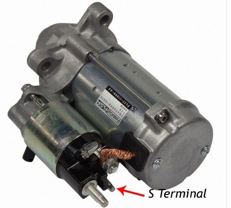

c)
Locate the S terminal on your starter solenoid shown above. Next time it doesn't start, use a jump starter cable, connect one end of red alligator to S terminal, turn your key to run position, connect the other end of red alligator to battery's + terminal. If you can start it this way, then your starter solenoid doesn't necessary mean it must be bad sine you said no crank no start intermittently. So you need to test this multiple times to confirm. A good starter solenoid should work 1000 out of 1000 times. A one time failure is not acceptable.
