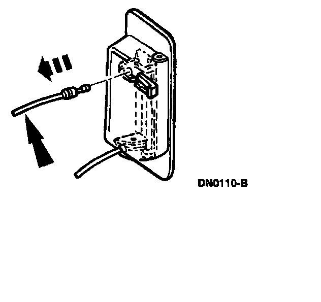

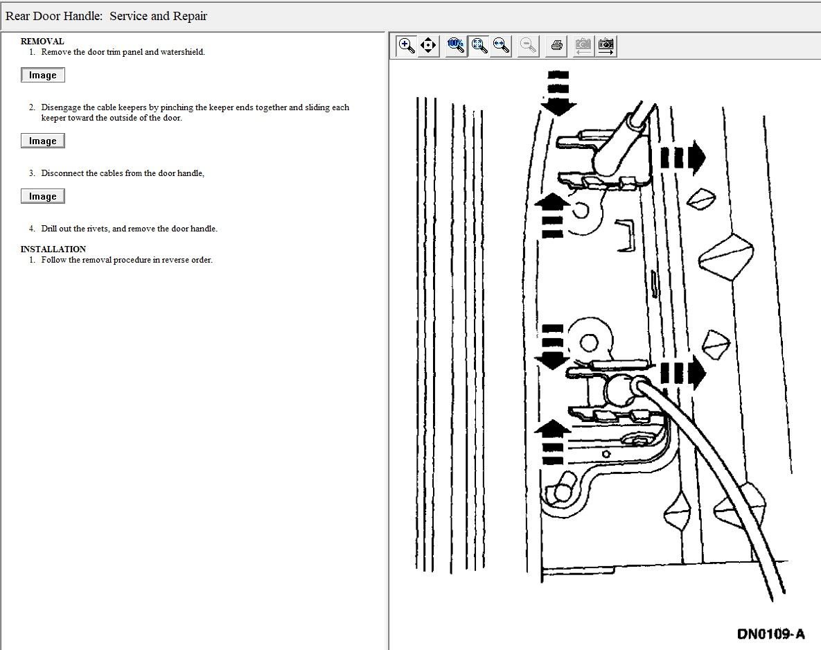

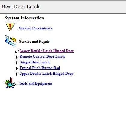

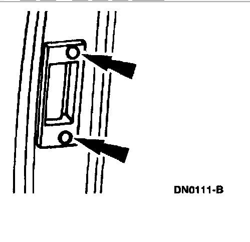

For rear door exterior handle check pdf below.
Rear Door Latch index page shown above. 5 pdf attached below.
And lastly the trim panel removals, the last 2 pdf.
I asked you 3 questions you replied none. On (3) have a look at https://www.ebay.com/itm/392035208100
I strongly suggest you to get the repair kit in metal like this below:
and return the ones you purchased previously.
