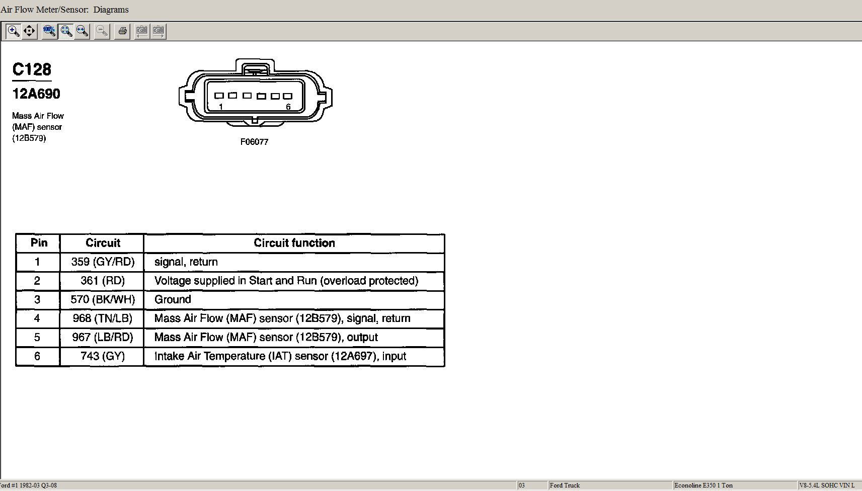

Engine off key out then unplug the electrical connector of your MAF (not MAP which your van doesn't have), then start it up and get a CEL (ignore it) and get rough idling (ignore it) and drive uphill again. If this helps then you either have a bad MAF or bad wiring that needs cleaning or repairing. It's fine to drive without MAF for diagnostic purposes since the factory default air-fuel ratio will be used when your ECU can't locate the present of your sensor. When the test is done just plug the connector back in then the CEL will go away. This test takes just a few minutes to complete.

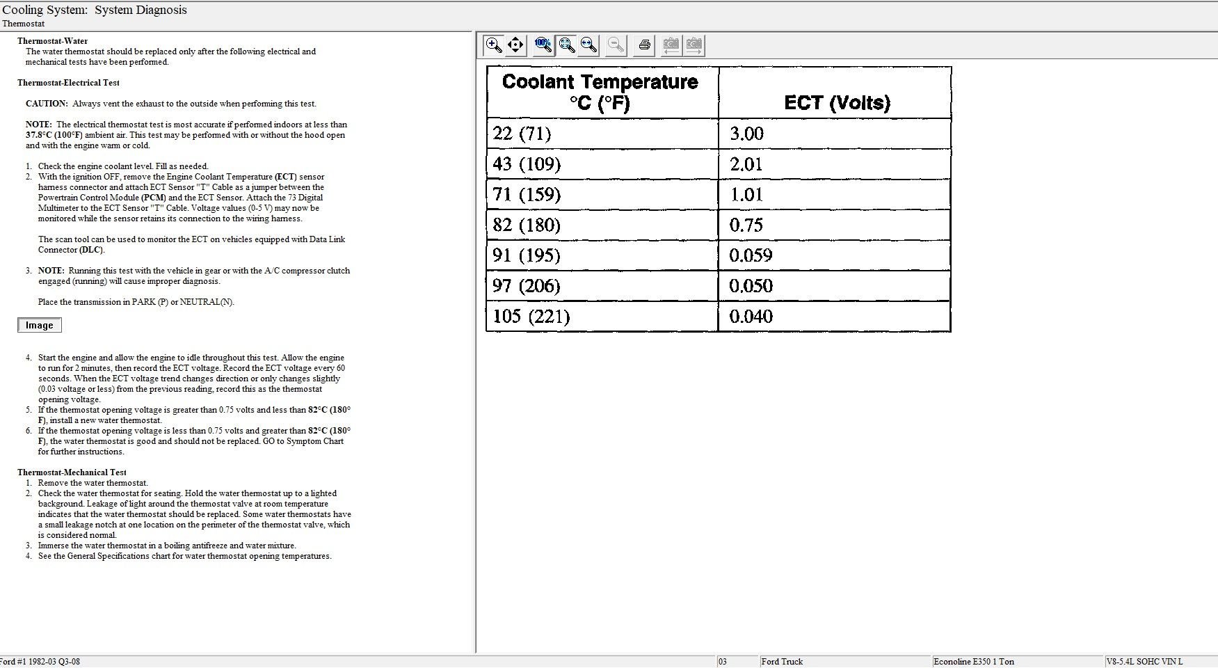

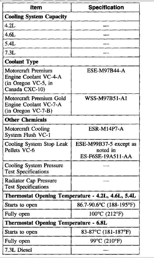

170 degree is way too low. Check below. You ever replaced your tstat and how long ago? A stuck open tstat can definitely cause lack of power.
