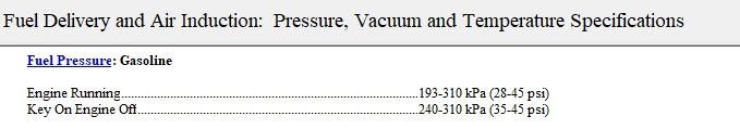

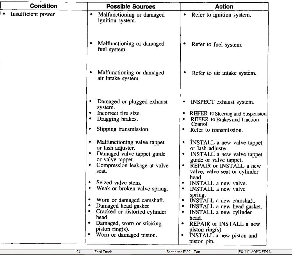

If MAF appears to be good there are many other possibilities still. You should check the easiest test first like vacuum-Test.pdf below then jump to the one that has higher chance, namely the fuel system.
