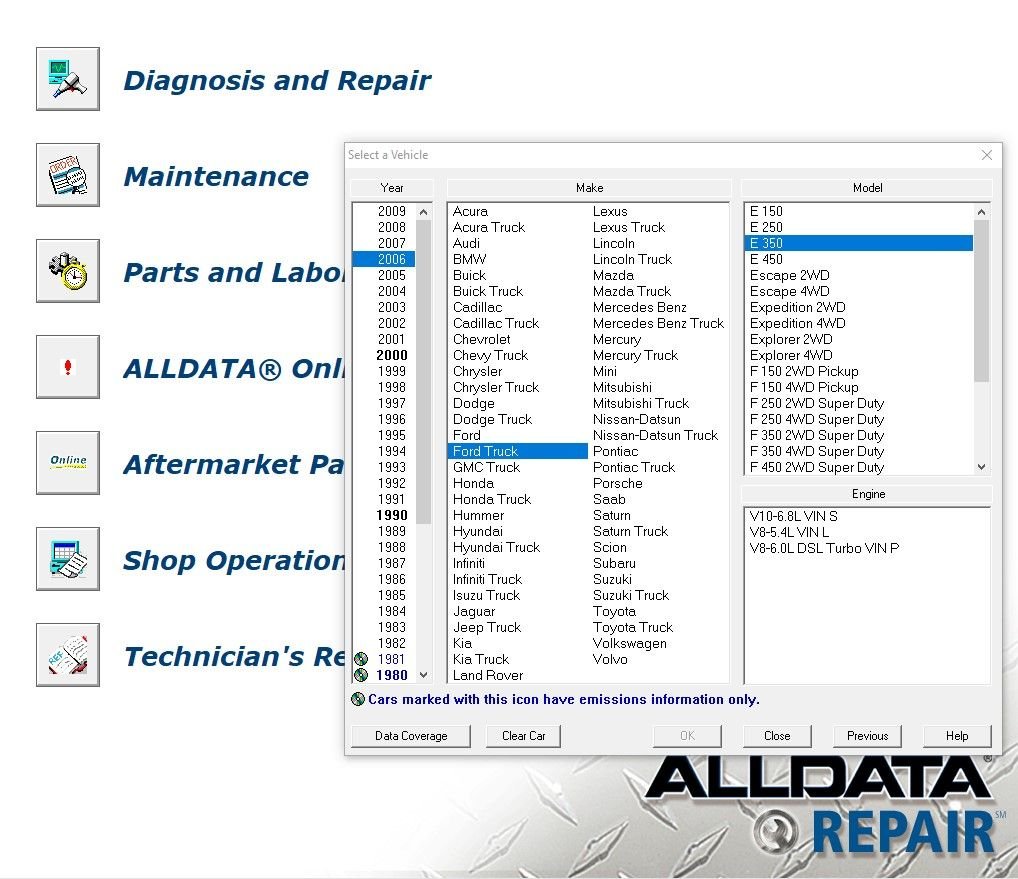

OK button not clickable because engine size is not selected, check my signature below to see why.
