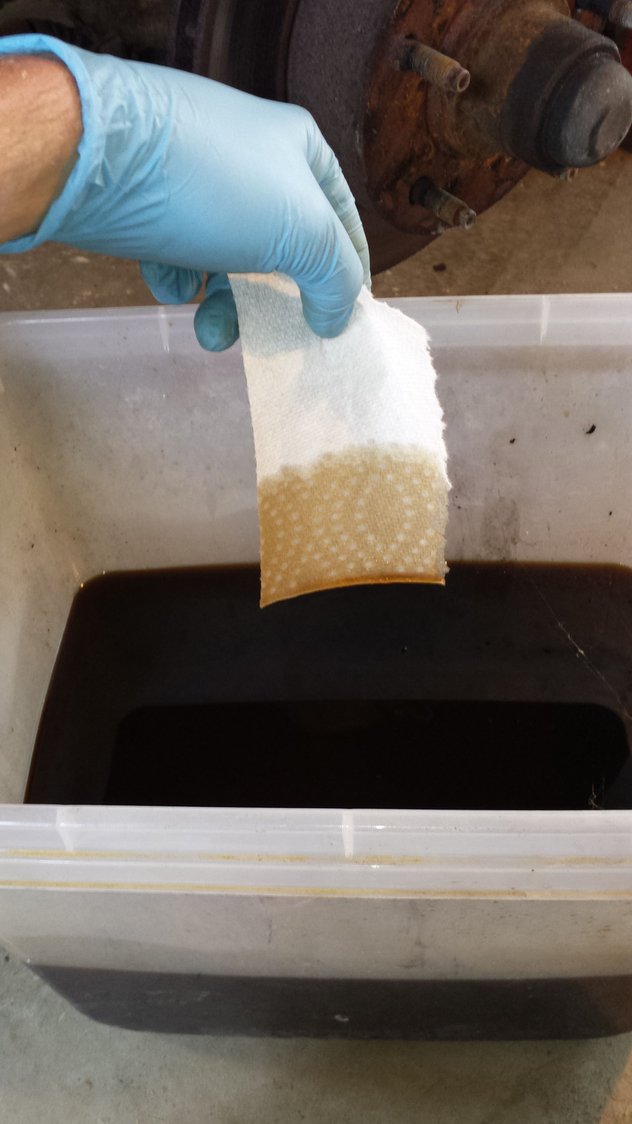

Check out what come out of the radiator drain...
My Haynes book does have an asterisk in the cooling system servicing section that reads, "Beginning in 2001, some models are equipped with red, long life coolant. Do not mix green-colored ethylene glycol coolant and red-colored coolant because doing so will damage the cooling system. Read the warning label in the engine compartment for additional information."
Not sure if this could've been the red coolant they were referring to.
