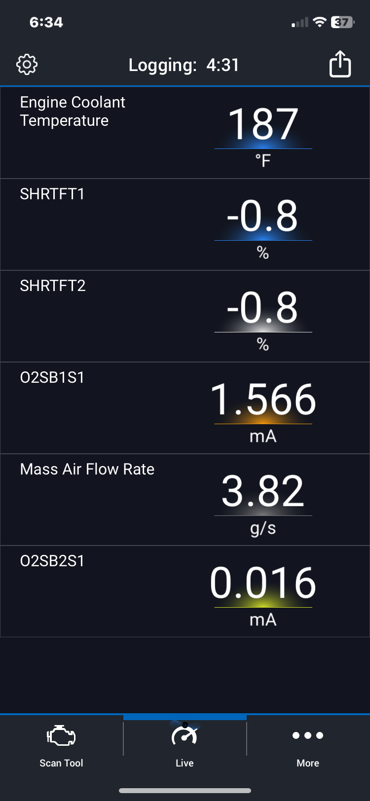

OK I couldn't do anything with the van today. But when I got home I took these 3 screen shots. Maybe a minute apart from each other at idle. These numbers are all over the place!
The Van is a 2010 Ford E-150 with 429000 kms (Canada ay)
And I didn't do the berryman 2611, I think I couldn't find the product at the time.

I forgot to say that the MAF was not showing zero while the engine was off.

Can you get your tool to show o2 volts instead of ma ?
Also need RPM values ,
So far looks like a problem with bank 1 unusually high fuel trim.maybe unmeasured air or questionable injector/function.

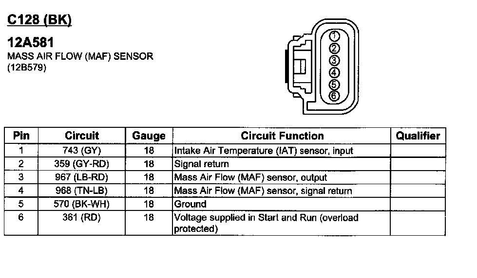

My alldata software covers up to 2007 so all diagrams/PDFs below are from a 07 E-150 4.6L.
You said your MAF rate got non-zero when engine is off, that's fine. Look at the 2 diagrams above, pin-6 (red) of your MAF gets power when key is in ON/RUN/START position.
You have 4.6L you should get 4 to 5 g/s, you have 4.27, 3.88 and 3.82. Altitude matters say you are at 1000 (from sea level) 3.82 g/s is fine. If you are at 200 altitude at 3.82 is a little bit low but it's still within spec.
If your engine doesn't stall while driving, you shouldn't worry about your MAF.
If you are curious you can unplug the 6-pin electrical connector of your MAF, then start it up and drive and observe its reading from your BlueDriver.

Your O2SB2S1 with 0.016mA that's way too low, I think you have a wiring problem (check all) more than the issue with your sensor itself. Need to see your B1S2 and B2S2.
