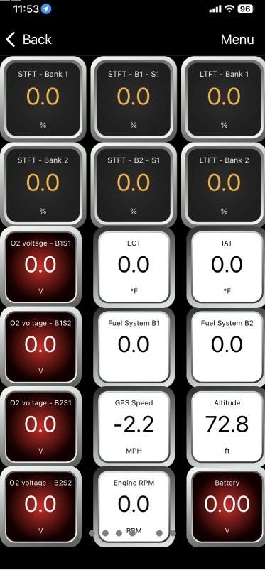

So what brand and where you got them from? Wideband on the upstream? You replaced the downstream narrowband too? When it comes to o2 or maf I would always buy genuine from Ford or Motorcraft.
On my very first post on top I already said it's a must to reset A/F adaptation whenever you replace o2 sensors. Once you reset A/F, all the hidden errors and issues can't be masked, compensated and adjusted by LTFT anymore, all of them will be revealed. You might have one DTC P2195 before, but 10 additional DTCs after the reset. When you address all 10 your van pretty much becomes brand new and very healthy. So the bad thing is you might need to spend $1000+ after the reset.
Here's a screenshot example of my OBDLink App using OBDLink MX+ adapter:
Your BlueDriver may vary and have different display available. You need to look at the LTFT first like I mentioned many times previously. When to monitor the values, your ECT needs to be at least 180F and your EOT as well need to be in operating temperature. You can have ECT with 200F but EOT is only 120F, simply drive a bit more and bring up the EOT.
