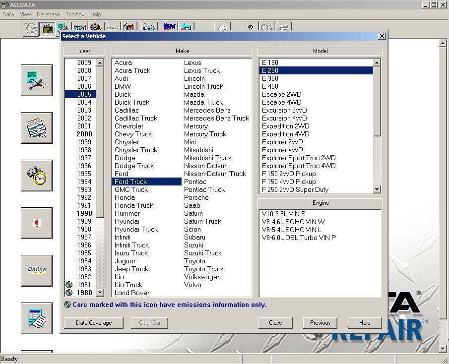

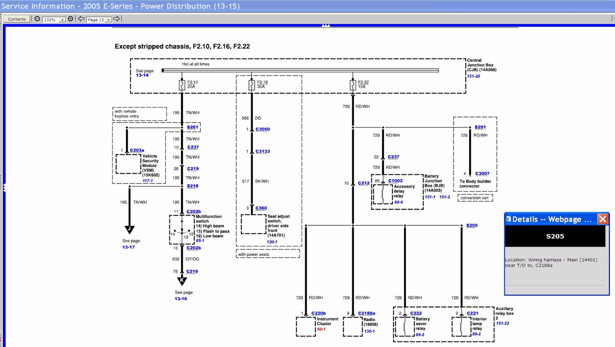

I believe the attached should help...
Note that C212 is in the RIGHT Hand kick panel which makes no sense to me.
Let me know if you need anything else.

Etinpa-----
wow--- that kind of hits the spot !
Am I allowed to ask where you find such good diagrams ? The dealer didnt seem willing to supply any......

I tried magnifying it but its just a bit blurry. are you able to do a higher rez version ?
cant quite be sure of the writing on the wires---

Hmmm... I have no problem reading everything right on the forum site... I'm not sure of attachment size limit on this site but, if you tell me which picture you want at higher res, I can try.
