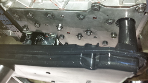

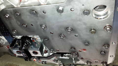

Got the seal out using a slightly larger screwdriver. But now the new filter, the correct one according to Autozone, just won't go in, even without the new seal, which i'm still not clear is necessary, because the new filter already has an orange seal. here's a photo of the new filter in as far as it will go.

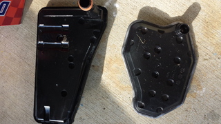

In the second pic that's the new filter on the left, Model# TF325, the old filter on the right is the TF403.
edit: the owner's manual states the correct filter is Motorcraft FT145, or Autozone TF95. This does appear to be shaped like the old filter. Heading down to pick one up now.

I don't know what is correct, but there seems to be some confusion.
Supposedly an Autozone TF325 is for a 4R100 trans.
A TF403 is supposed to be for a 4R70W.
The next best thing to do is find that trans code on the driver's door sticker and find which trans you have in the vehicle.
What is that trans code?

The trans code is F. I still haven't found a diagram to decode it. Just got back from the store. The Motorcraft FT145 is definitely not correct, as it's a screw-on filter. So I picked up the TF403, same as the old one, which Autozone computers say is for a 20-bolt. However, it comes with a 14-hole gasket, although the old gasket is reusable anyways. It would seem the computers are wrong, because this does appear to be a 4R70W. Going to try this one on now.

The way I understood it was,
A code R was a 4R75W
A code F was a 4R70W
If you have the filter for a 4R70W , you should be OK.

the TF403 popped right in there and everything's up and running. Thanks everybody!
