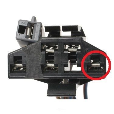

I'm going to try and find an image of the diagnostic plug online. I want to make sure I don't go grounding the wrong terminal. Would that be the same as the OBD test port location?

Is this the diagnostic port and have I circled the correct pin?
Old Aug 19, 2023 | 06:46 AM
Posts: 16,628
Yes !
