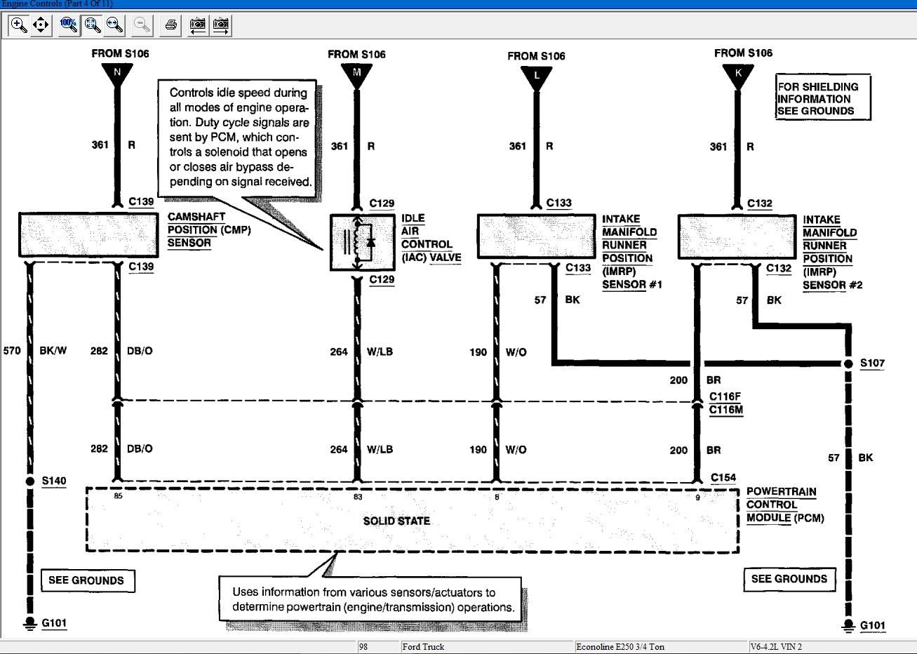

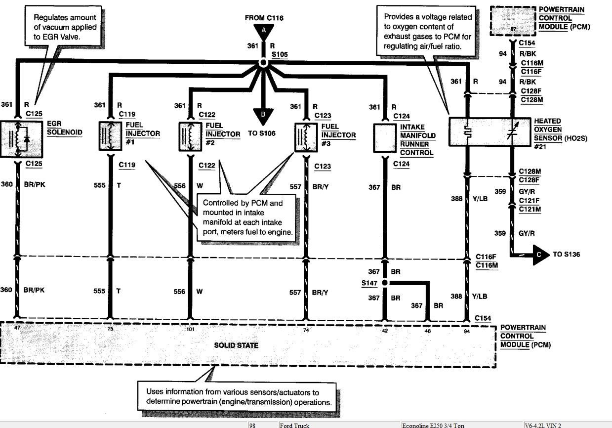

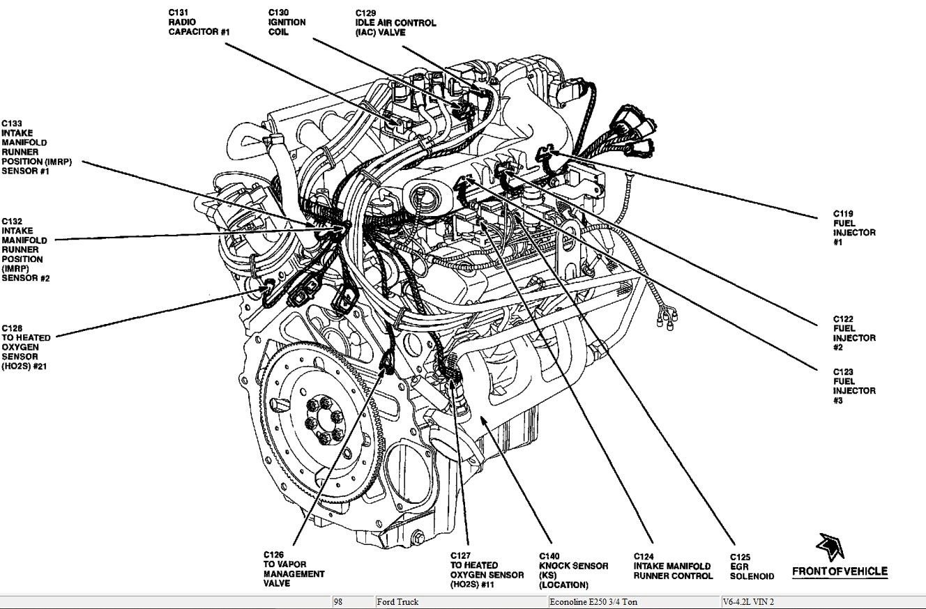

1) which connectors are negative and positive on the right and left intake manifold runner control valves on a 1998 ford econoline e250 van v6
2)how do you bench test each(circuits and vacuum)

1)we would like to know how to test the imrc circuit(the three prong on the imrc, not the connector) to check if the imrc circuits are good

Check the 3rd PDF I attached previously. I attached 3 pdf files for a reason.
If you have any DTC please provide.
