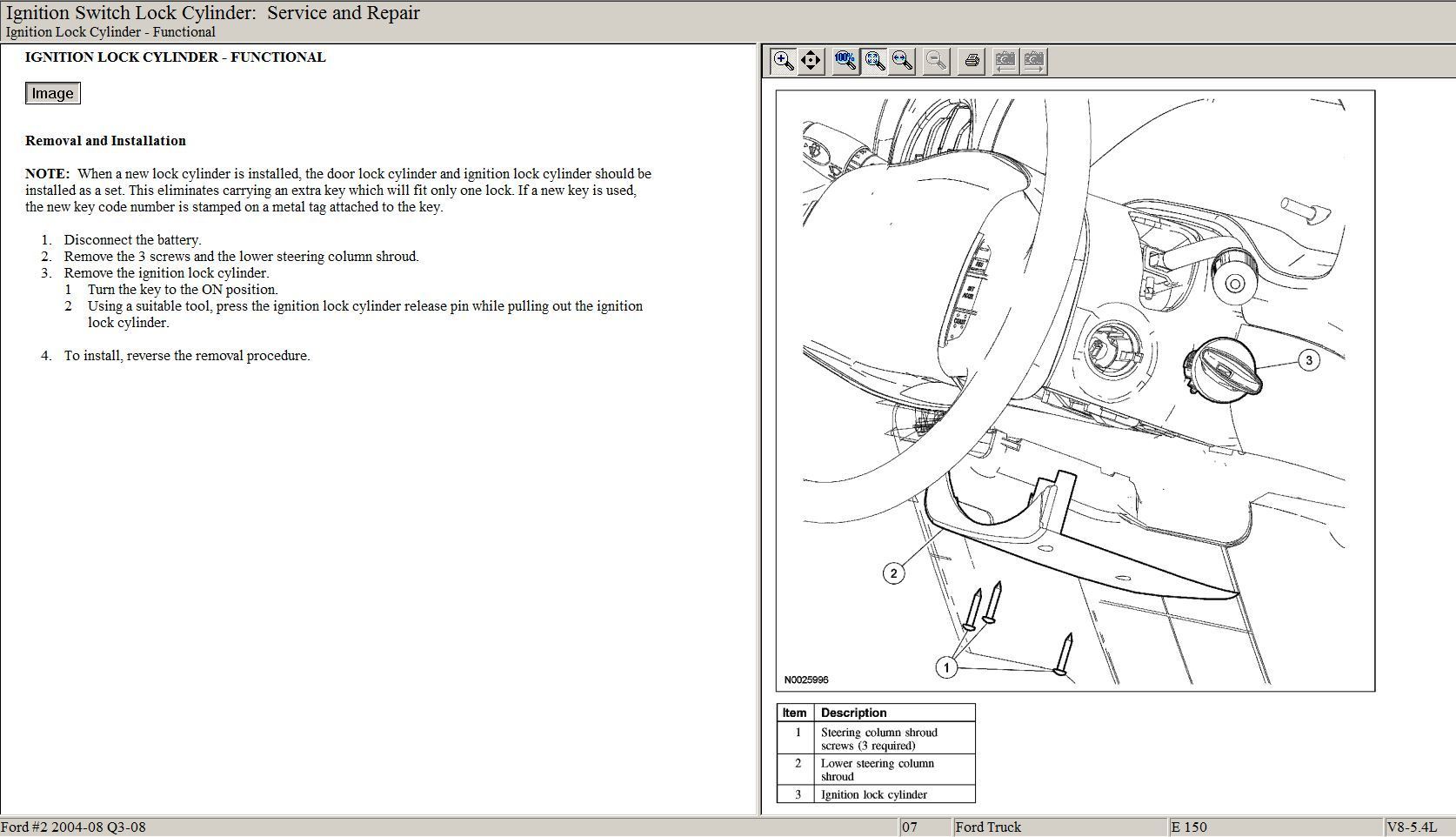

1) Follow the removal procedure above.
Note on Step 3-2, suitable tool for example is an allen hex key. Use the biggest key (in diameter) that is slightly small than the hole. Never use pick tool the tip is too sharp to have full contact with the release pin inside the hole. Small flat head or phillips is also not appropriate.
2) Once you get it removed along with the key, you can then release the key easily.
3) When it comes to any key lock or pad lock w/ key or code, use only dry lube to lubricate. The typical WD40 can damage your lock cylinder further. WD40 brand makes a specialist dry lube you can get it from any hardware store.
