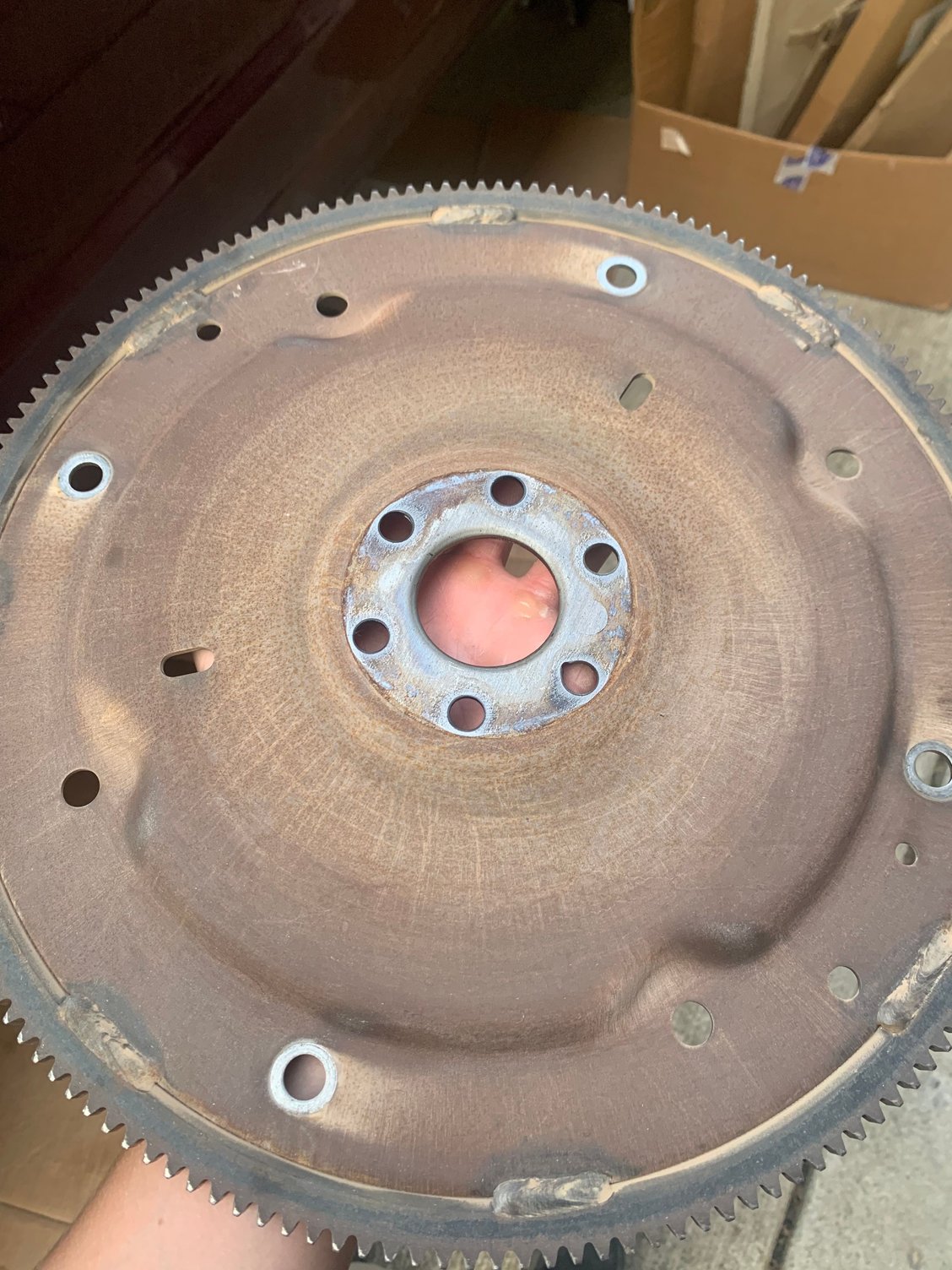

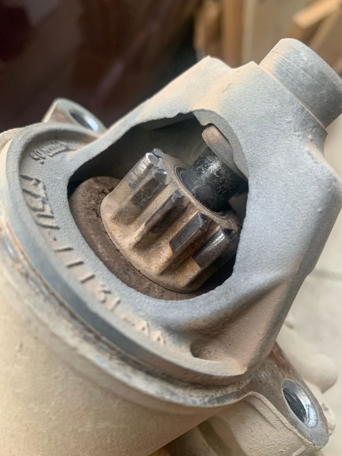

A while ago my 2006 e250 began to make a loud clanking noise when the engine was started. The sound came from the area between the trans and block (flexplate, tc area).
The noise comes when the engine is started. It is the worst in reverse, goes away when in neutral, and is heard a little in drive and park.
The noise goes away after a minute or so of driving or idling.

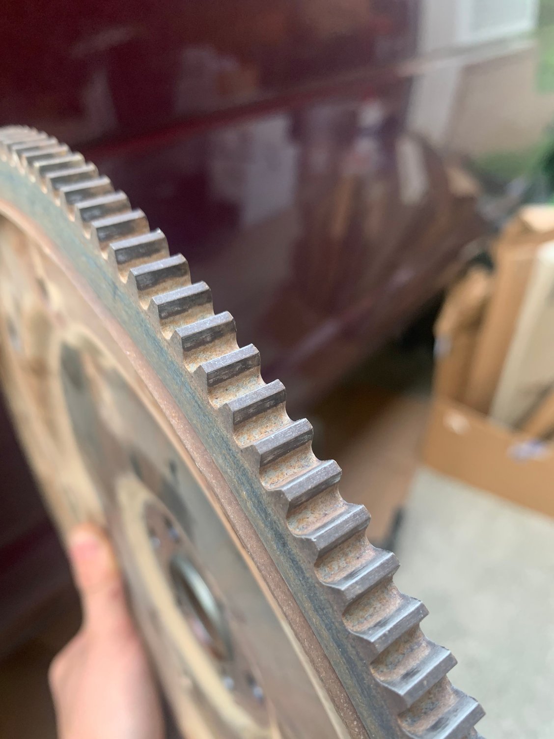

Did a little research and read that the flexplate is the probable culprit. I dropped the transmission today and I can’t find anything wrong. I have not taken the torque converter out but it seems in good shape and the flexplate is not cracked.
I am stumped, if anyone could help that would be greatly appreciated!

I wish I did that before I tore the thing apart. I was certain it was coming from the flex plate area. Flex plate and bolts are all good and tight. No signs of any metal contact. I’ll bang the cats and see if there’s any rattles. Could it be the torque converter?
