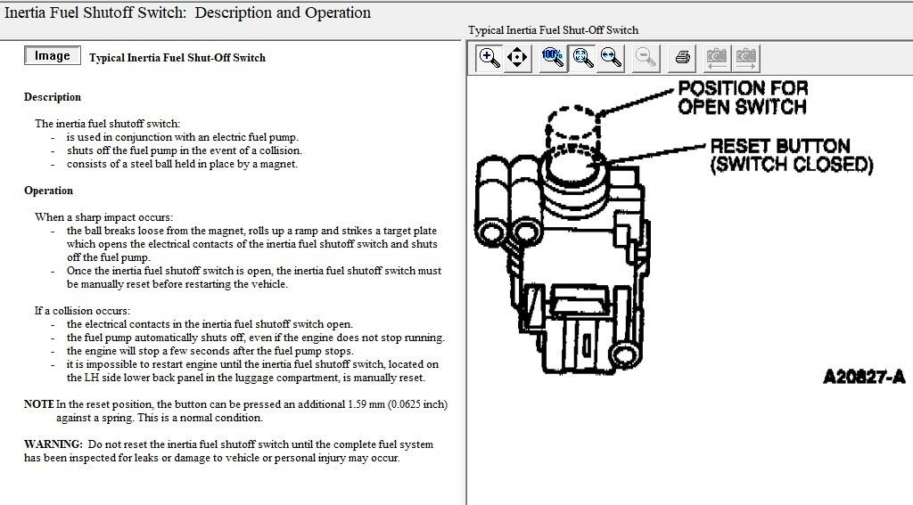

Have you checked the inertia switch yet? Remove the passenger side kick panel you will see that.

I check inertia switch and he work perfectly fine, and I figure out in in 30 pin of relay fuel pump I see 12v and in 86 pin of relay ground is here. And if connect 30 pin with 87 pin fuel pump is turn on, and relay is working. And in 85 pin there is not signal to turn on relay fuel pump.

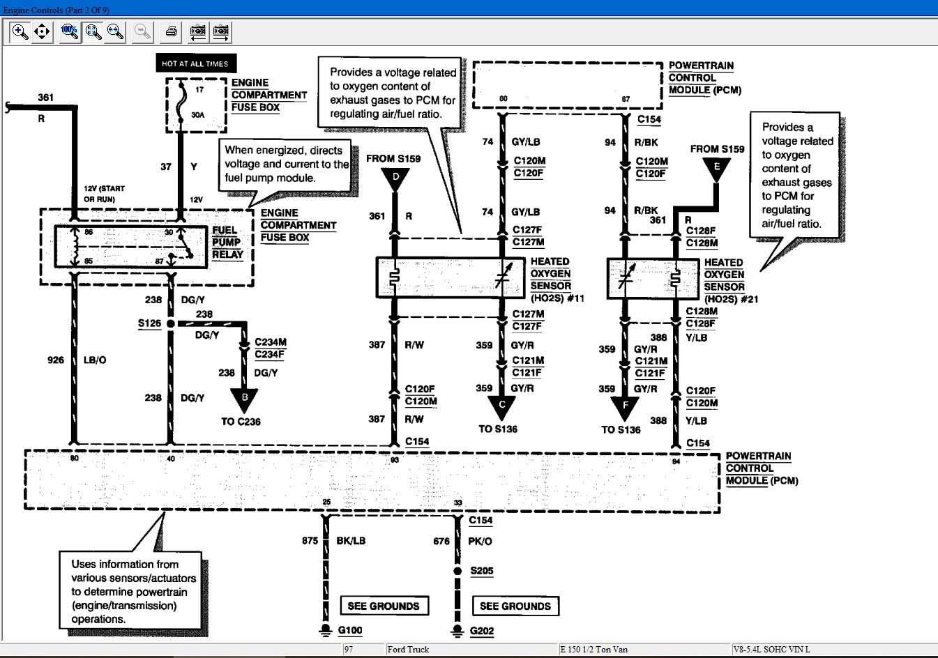

And if you can pls send some diagram.
Old Jun 5, 2025 | 03:59 PM
Fuse F17 (30A) connects to Terminal 30 via circuit 37 (Yellow wire), this is hot at all time you said no problem.
Terminal 85, LB/O (light blue/orange) wire, remove the relay and probe it you should get ground signal from PCM (pin-80) thru circuit 926 at all time.
Terminal 87, the DG/Y (dark green/yellow) wire, connects to pin 40 of your PCM thru circuit 238, unplug the relay and pcm connector, use ohm meter set the dial to 200Ω and probe both ends you should get 2ohm or less.
Terminal 86, the R (red) wire, remove the relay you should get battery voltage there when key is in RUN or ON position, this is the trigger wire.
C236 goes to inertia switch
