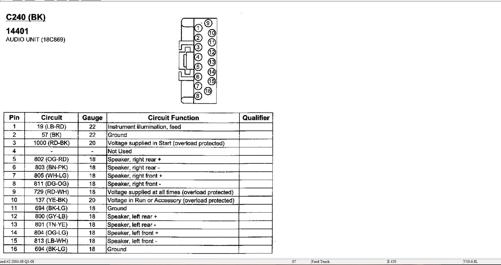

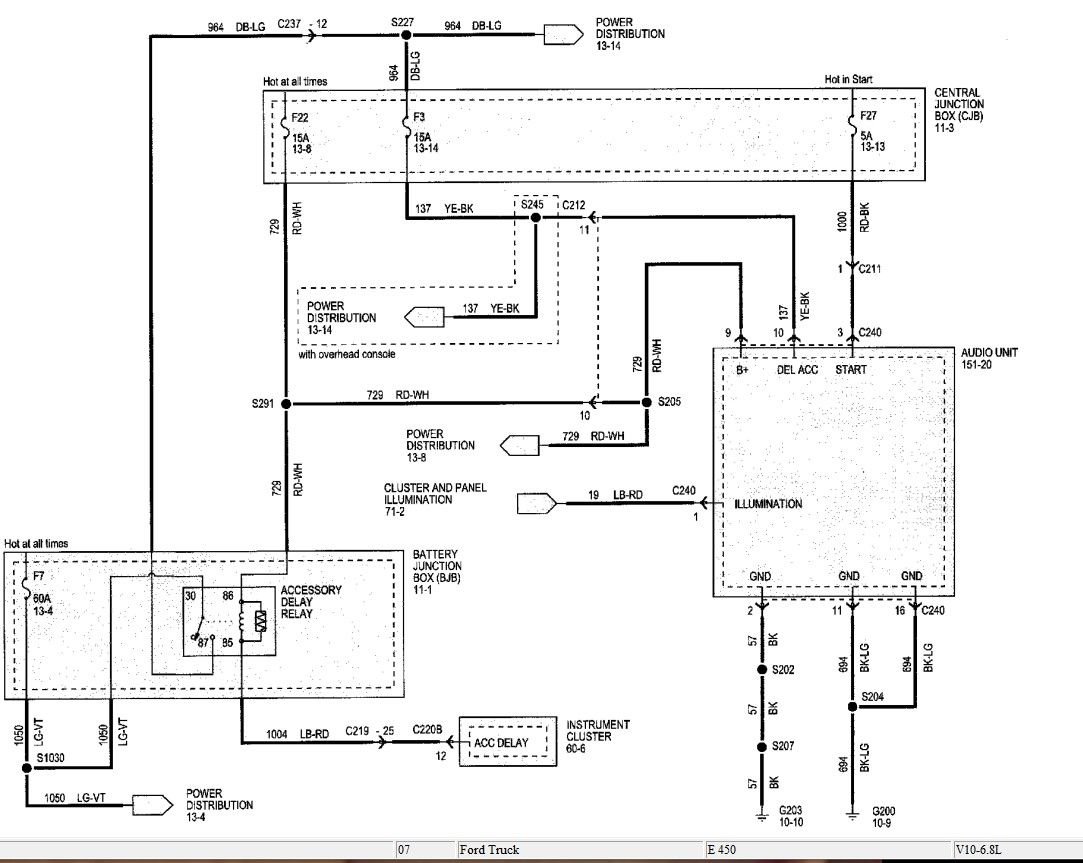

Do a reset and see if it fixes the problem. If not, just get the radio wiring diagram and then pull the radio to find out what's wrong.
I don't have diagram for your van, but in general there _should_ be 3 power wires going to the back of your radio: 1) hot at all times (this is the memory power), 2) hot in ACC or RUN, and 3) hot in START
And you said you have problem with "hot in START" so find out why. Also don't forget there should be 3 separate fuses you have to check, not just one.
I don't think it's the ignition switch problem (maybe just a bad connection in between the harness) else your van would have a lot of electrical devices not functioning.

It might be possible to do a factory reset on your radio, look up your owner manual or google to find out. Disconnecting the battery probably can't reset it. Check the fuse(s) first.
2 diagrams below for 2007 E450 V10, like I said I don't have any for 2017, but you can get an idea. Even if the hot in start fuse blown, you are going to have to pull the radio to find out the root cause why that fuse blown, like a short to ground or loose connection.
