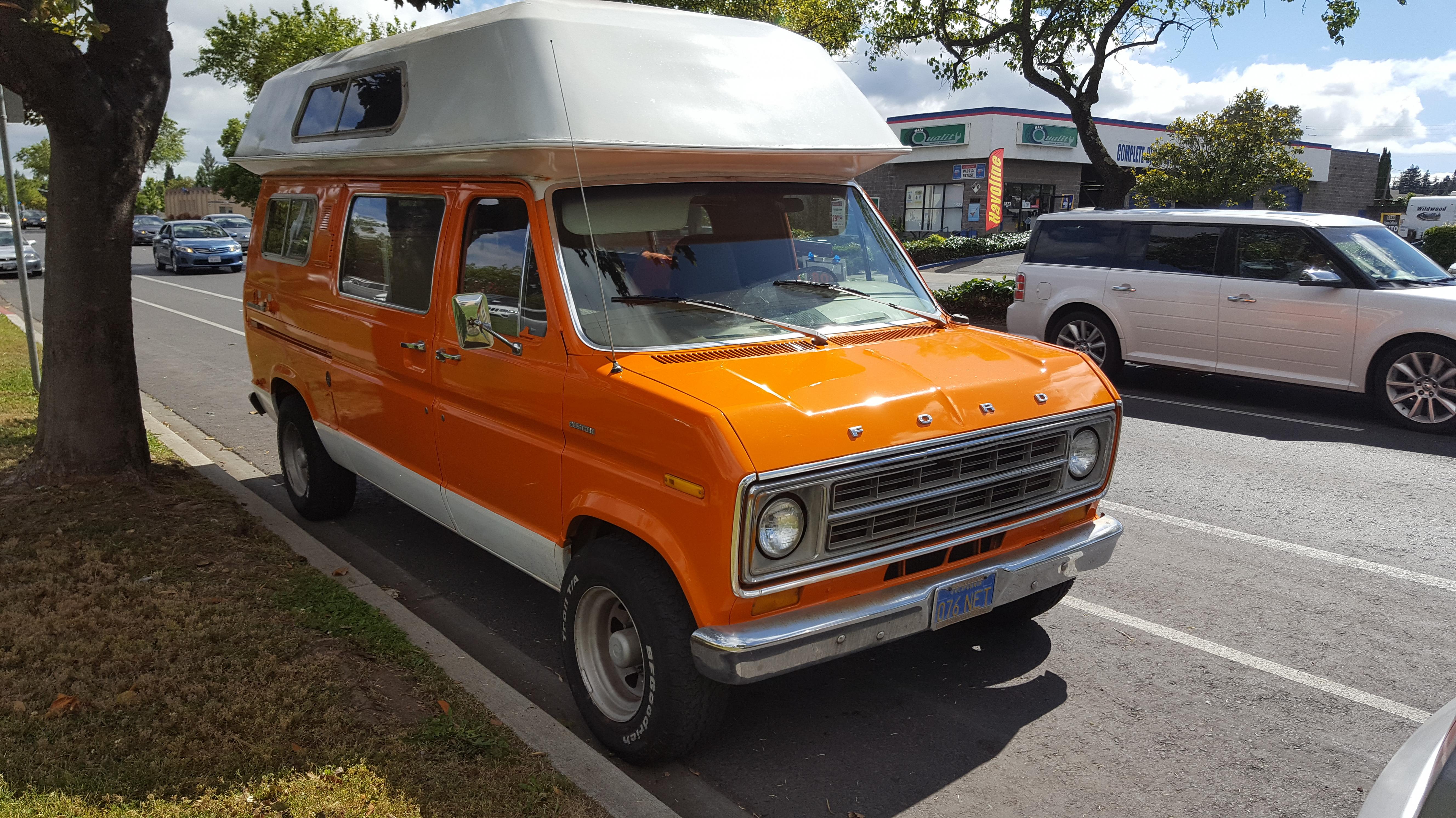

There is a 1975 E250 with the 460ci 385 V8 in it and a camper conversion up top from that era as well. 132K miles, fair state. Attached is a photo.

1. I am having it inspected on June 2 of 2016 at a place that was recommended for their ability to assess frames and frame issues. What should I look for and what questions should I ask about the frame itself and things like rust or damage or excessive wear? Looking underneath it, I can see the differential has surface rust on it and things do look a bit corroded, but I can't tell what's surface and what's not. Will a reputable shop tell me as much?

Looks like a clean van. You live in the rust belt?
A reputable shop should certainly be able to tell surface rust from rust from that would/could affect the frame and body 'structurally'.

I would think if it were in a corrosive environment long enough to weaken the frame, it would have shown up by now in the body panels as well. Surface rust on the frame, probably a given. Flaky, blistering frame sections or collection points, would be another story. That said, to make room, and carry the diesels extra bulk, you'll need to add/remove some iron..

And crap.... Flaking you say? I did see some of that on a bit of the rear undercarriage and differential... I guess I'll wait to see what the shop says on Thursday, but now I'm a bit apprehensive...
