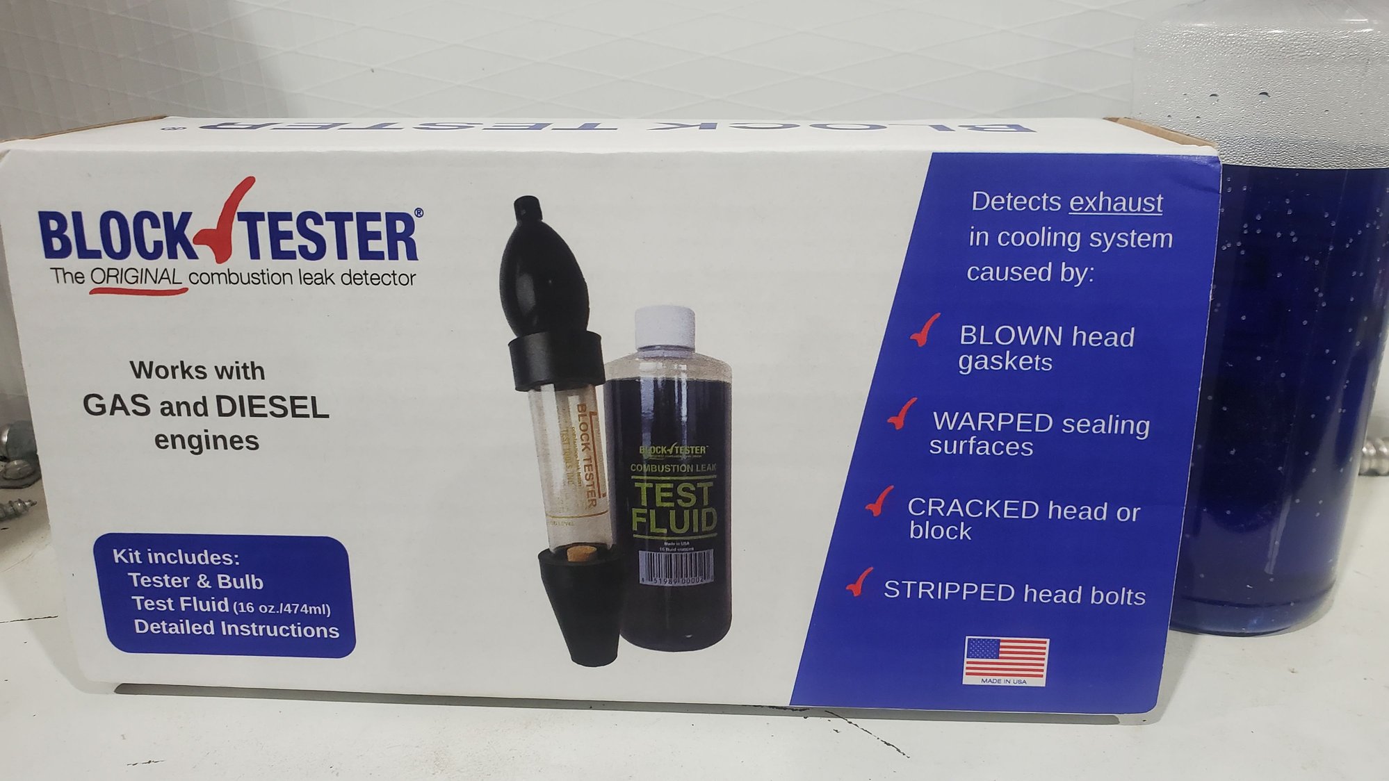

Here is a pic
I did this test, and the coolant level rose from 20foz to 50foz and when it cooled it went back to 20foz. It did bubble when it filled up and the van was at temperature.
I did this test for exhaust and it came back clean, no exhaust in the liquid and never turned green. I am at a loss for this at this point, help please!
