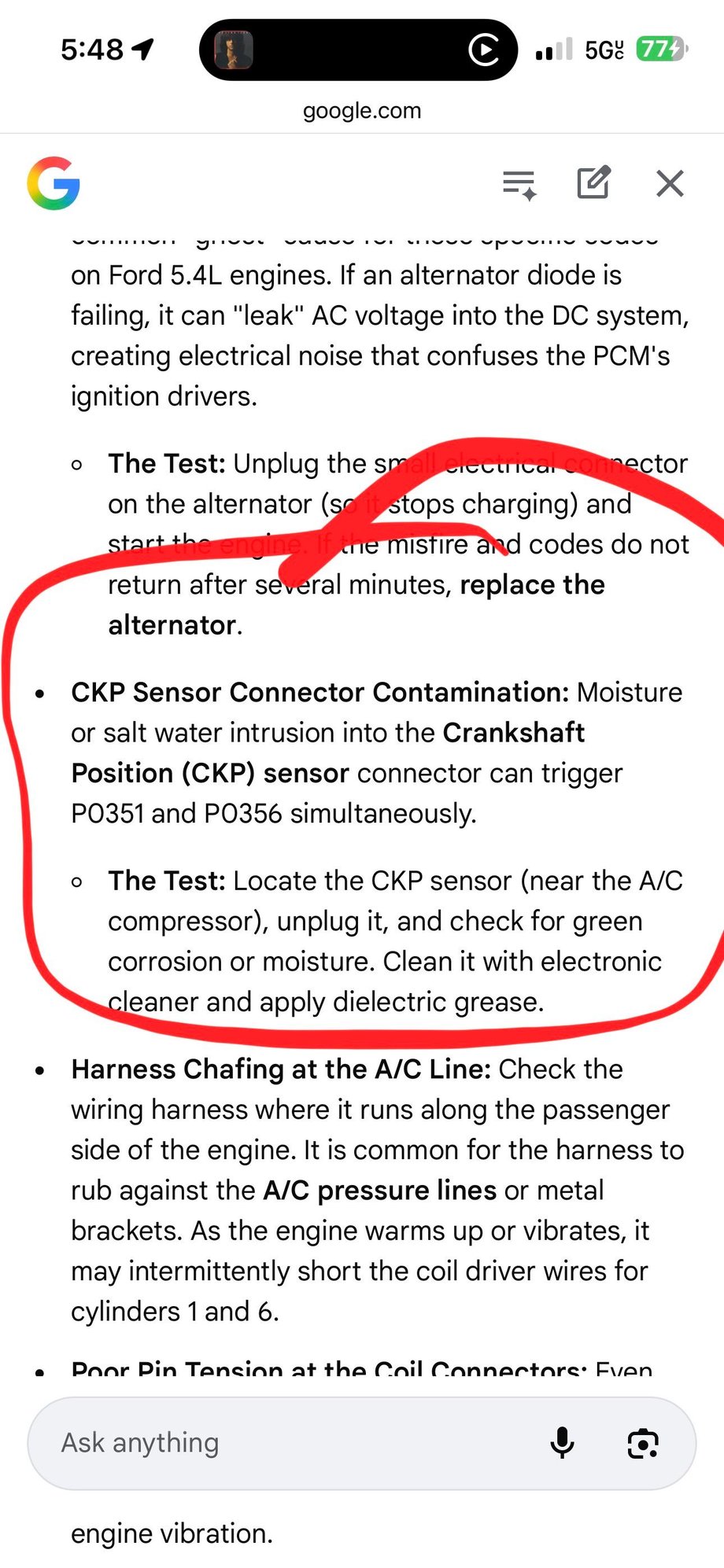

Do you think this is the problem then?

That's an oddly specific match to your issue. I'd definitely check into that.
If I'm reading it correctly they're saying it's a problem in the connector, not the sensor itself. Do you read it that way as well?
yes the connector but I guess I’ll check the sensor too
