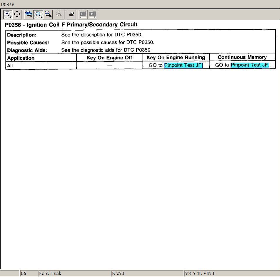

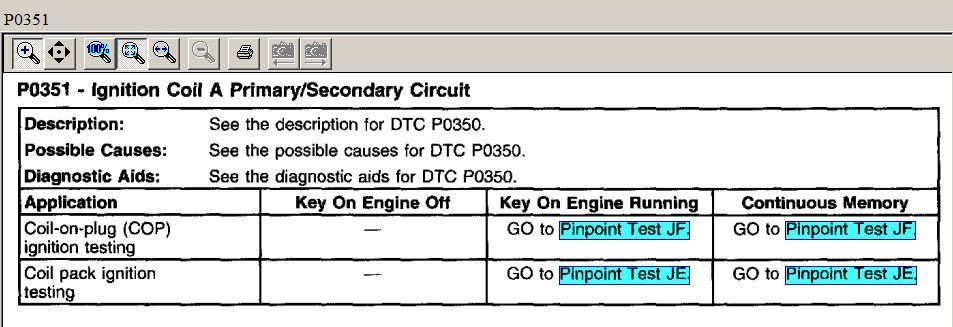

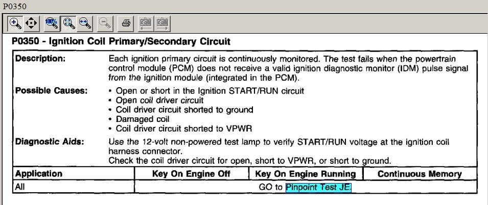

You can have 100+ DTCs without a check engine light. Just because you are seeing a CEL with P0351 and P0356 doesn't mean these two DTCs are more severe and critical than the other 100+ DTCs. To retrieve other non-P DTCs and non-P0xxx DTCs you need a scanner capable to retrieve Ford's specific DTCs, Foxwell NT510 Elite w/ Ford software and OBDLink MX+, a good combo you must buy if you really want to diagnose this yourself. When you see only the two DTCs that indicate you are using a generic scanner, which is next to useless but better than no scanner at all.

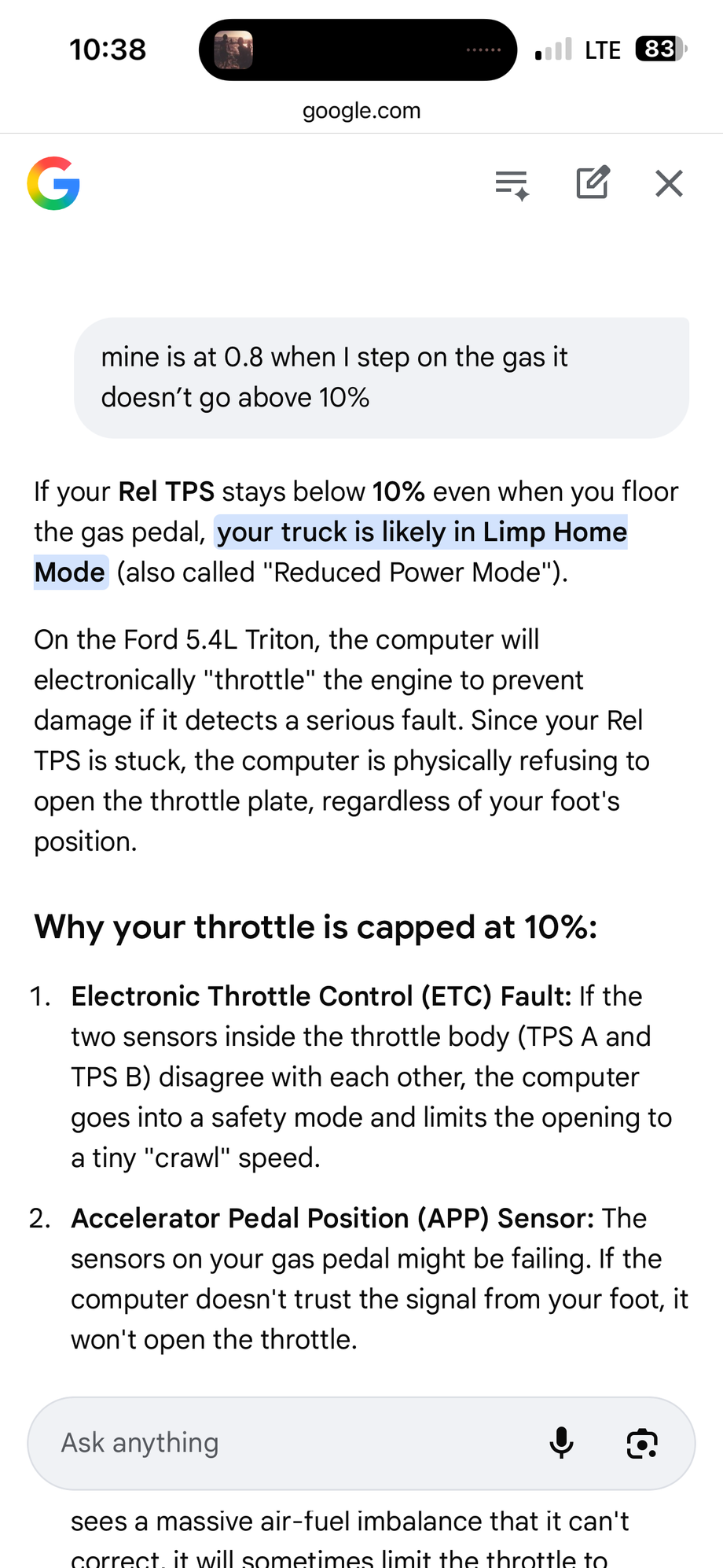

I checked fuel scan. Everything seemed to be fine. I had an extra alternator laying around so I swapped alternator and check all wiring everything seemed to be fine. However found some new things after I erased codes and a started I let it idle for 30 minutes while I was checking scan for fuel no misfire it ran fine. Took it for a ride and it seemed like it started misfiring after about 2500 rpm. Ordered a new crankshaft sensor and a smoke machine to test for leaks these are next to things I will do. As per google. The ecm is putting me I. Limp mode for some reason. I’ll attach a image about that

Default Issue resolved.
Issue resolved
Added new crankshaft position sensor codes went away
