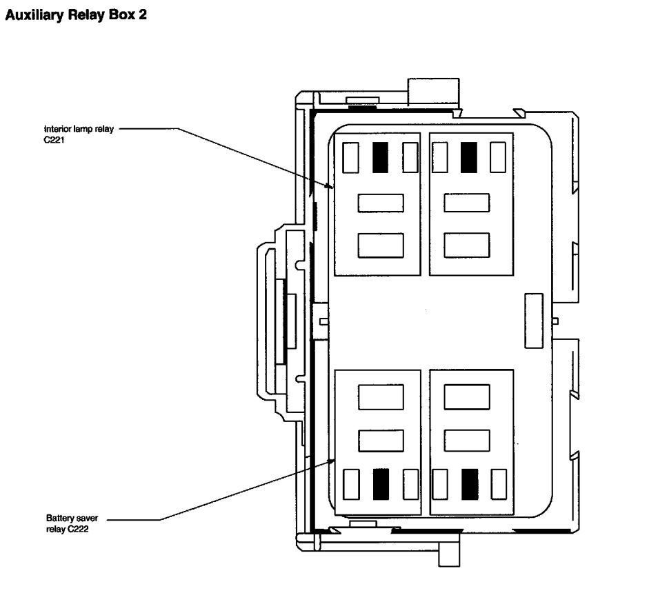

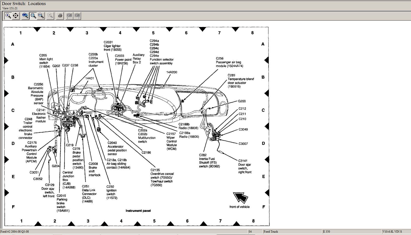

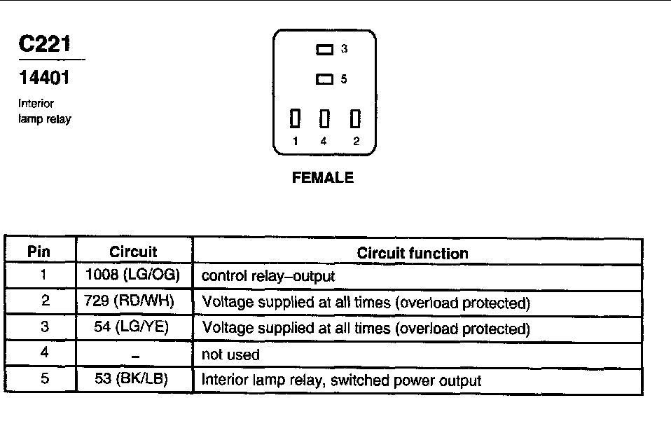

Full wiring diagrams in pdf below.

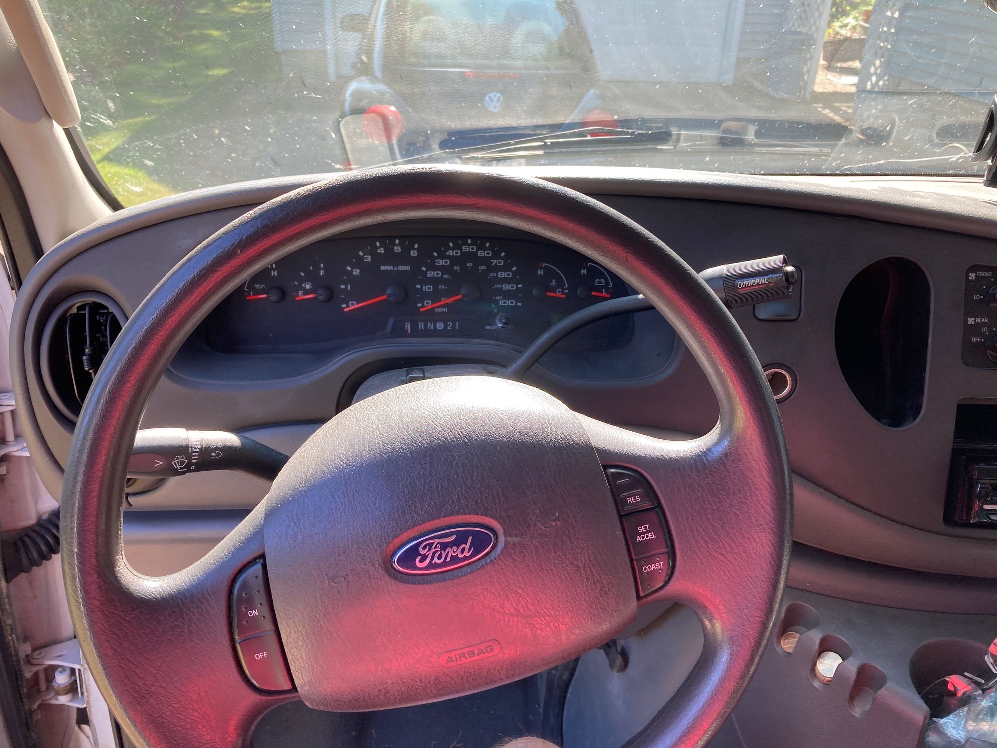

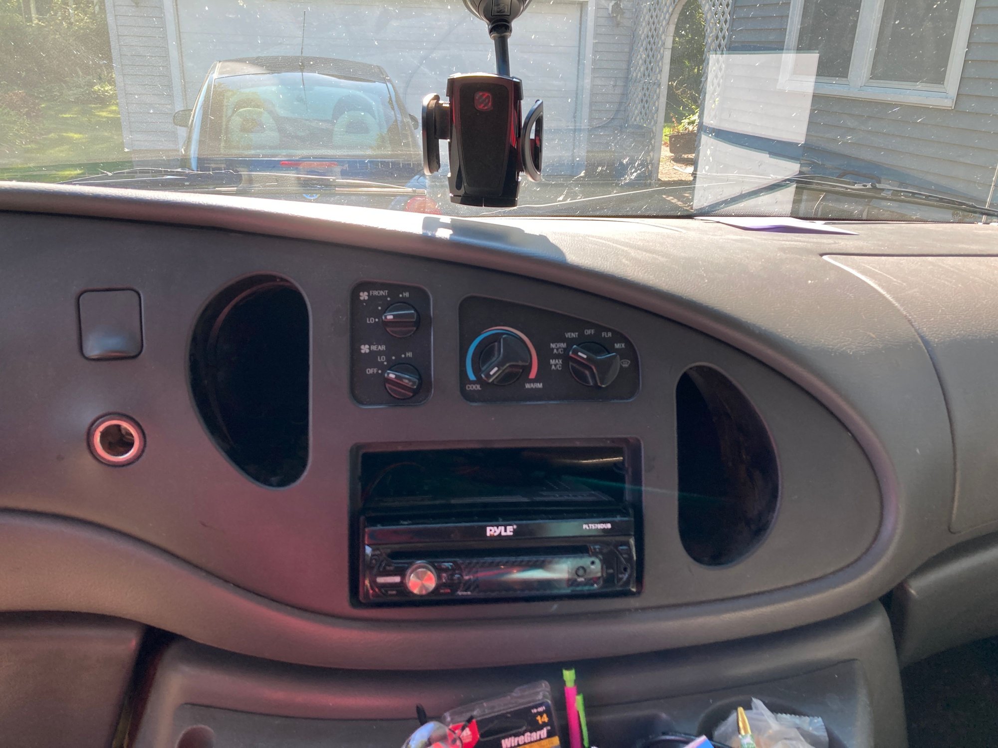

Here are some pics of the dash that I need to remove. As far as replacing the relay, it all goes back to the following thread where you suggested that's what I should do:

Old Aug 13, 2024 | 12:25 PM
You have one piece panel, you have to remove the stereo and the headlamp switch in order to remove this whole panel. Remove the stereo first.
If you search youtube quite a few guides are misleading telling you to pry the headlamp **** and you get scrub marks afterward. Instead, you need to:
1) remove the knee panel under your steering column, crimp from the back and pull from the front, do that one by one
2) behind it is a (usually rusty) bolt-on metal panel, remove that, then you should have enough room to get to the back of the switch with your right hand
3) do it from under the steering column, use your right hand and get to the top of the headlamp switch, there is a metal tab you simply press down, then use your left hand to pull the ****, then the **** along with its skinny pole should come out together
Before doing step 3 it's best to turn your **** all the way to the left or right so you can remember its position, it helps when you put it back in since it's more difficult on that.
4) once you get the panel half out, what's attached to the back is 1 connector to the power point, 2 to the cigar lighter
5) lower your shifter you should be able to pull the entire panel out
You might not need to remove it entirely to get to the relay, it should be behind your cigar lighter.
BTW I see that your shift indicator is not aligning 100% pointing to your PARK position, there is a white **** (only one white **** in the surrounding area around the size of a quarter or smaller) very close (within 6 inch toward the center) from your ignition switch, you turn that **** by hand clockwise or counterclockwise to adjust the indicator needle position.
