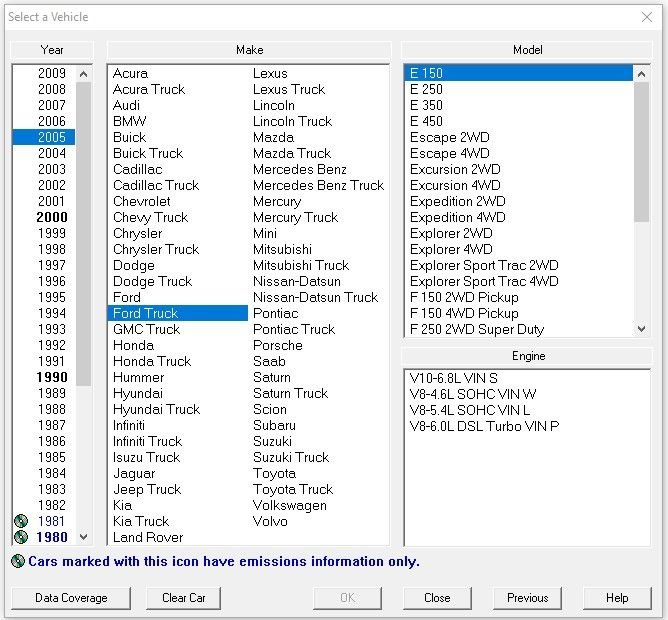

Posts: 1,254
OK button not clickable because Engine is not selected. Please check my signature below.
