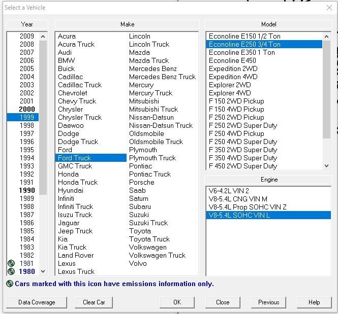

VIN L or M or Z, I picked L (the 8th character of your VIN)

"L" is correct, but this is for oil filler tube. I am seeking the Transmission filler tube removal please.
Old Jan 5, 2026 | 06:19 PM
Posts: 1,229

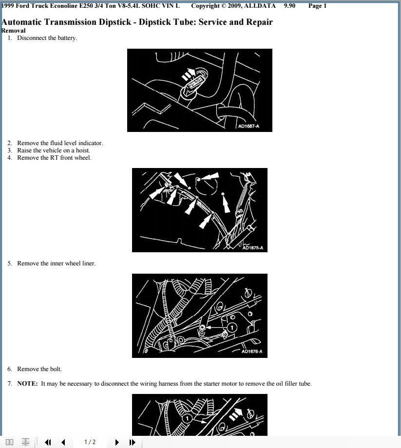

Screenshot of what i submitted previously.
Transmission dipstick tube and filler tube is the same tube.
