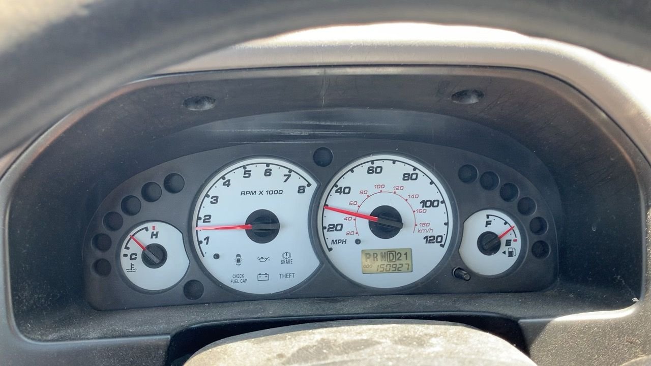

My son came home from college this weekend with an issue with his 2001 Ford Escape. During normal driving (*13.9 v) and you accelerate to >3000 RPMs to pass a vehicle, several instrument lights flicker, the instrument gauges sweep full down (counterclockwise) (*19 v), take foot off the accelerator, gauges stay a zero, then within seconds they rotate full up (Clockwise) (*18 v), then within a few more second they rotate full down and then almost immediately the gauges normalize (*13.9 v). The engine never skips a beat. If you progress smoothly from 2500 RPM through >3000 RPM nothing happen. If at this point you punch the throttle the anomaly happens.
*Alternator output monitored at the battery
The engine light was not on when he came home after driving 200 miles. but did come out when he was out with friends. I checked the code and erased them and then I changed the oil pressure sensor. The engine light did not come on during the drive to get the above information.
Engine light is also intermittent and I came on during start after the sensor change. Not sure if the two issues are related.

This may or may not be part of the problem, but when we get a series of unrelated problems a good part of the time there is a ground connection problem. Might not be a bad idea to check and clean the grounds starting from where the ground originates at the battery.
Old Jul 1, 2020 | 07:49 AM
jimbo50's Avatar
Joined: Jun 2020
Hanky, Thanks for the reply. Good idea, we'll go through the system and check the grounds.
