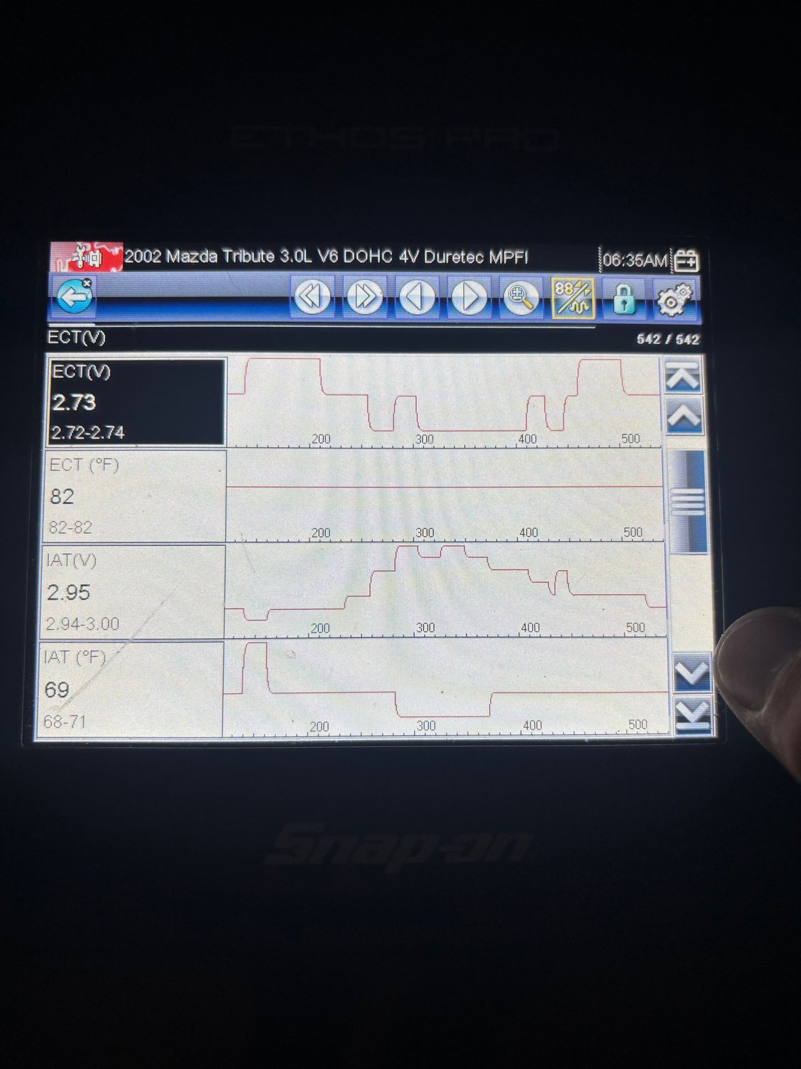

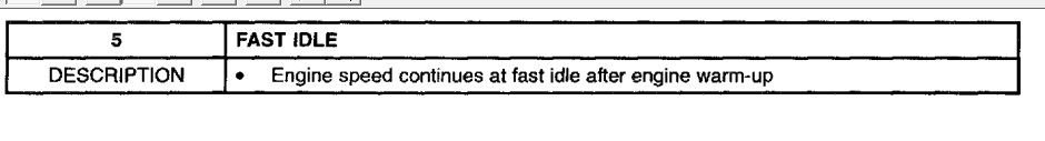

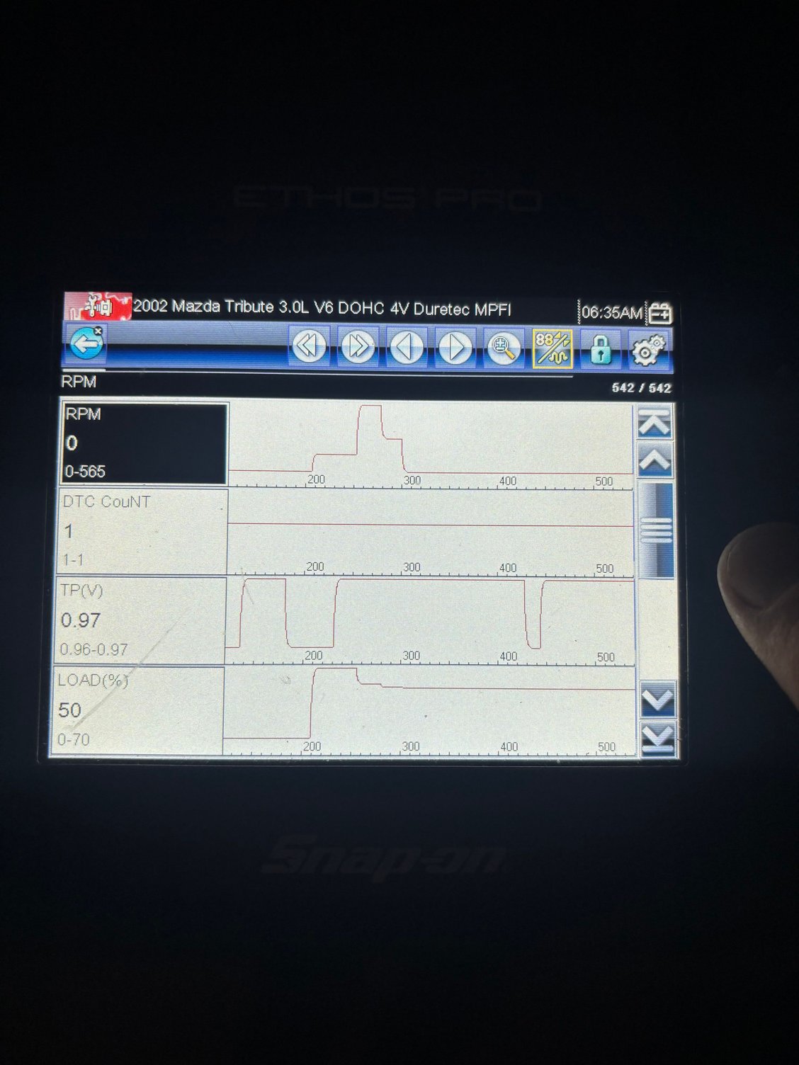

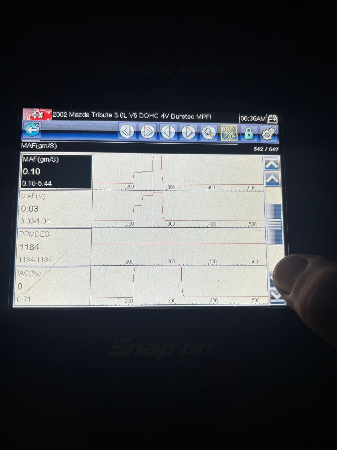

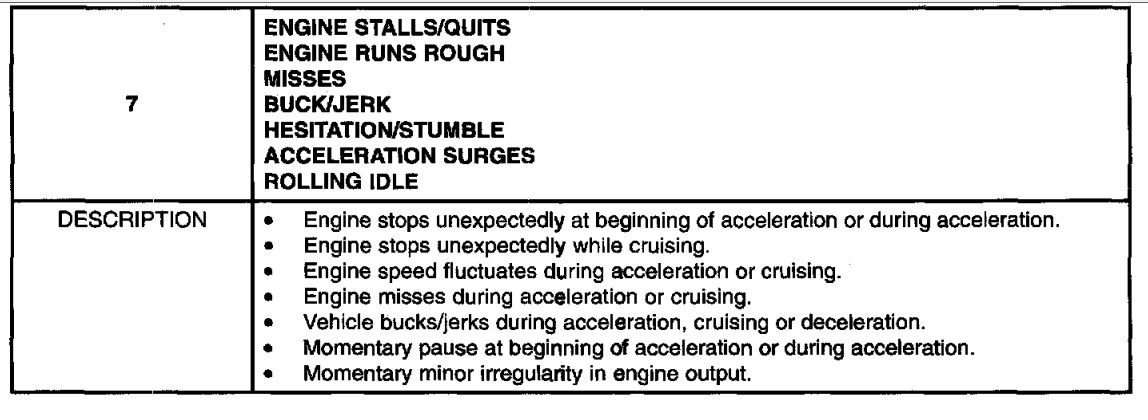

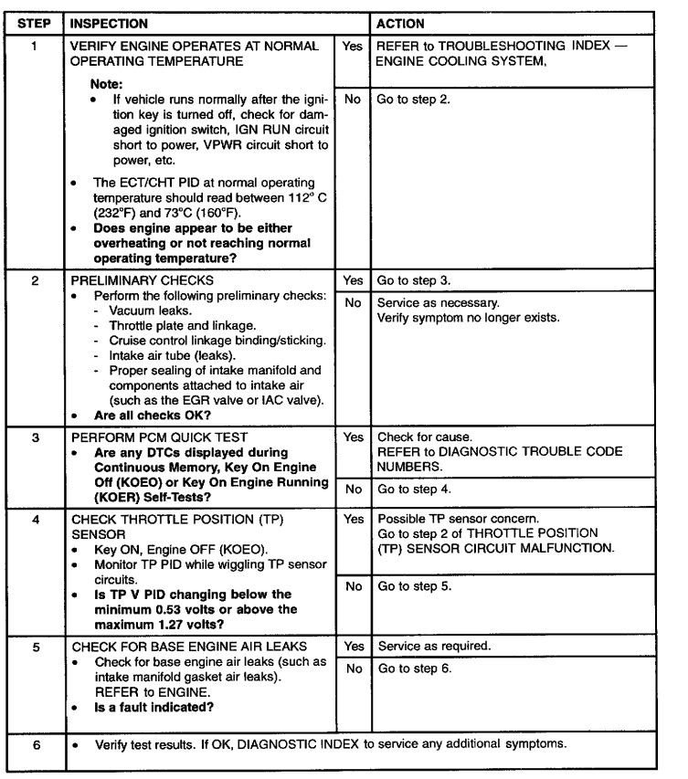

Old Apr 9, 2026 | 05:53 PM

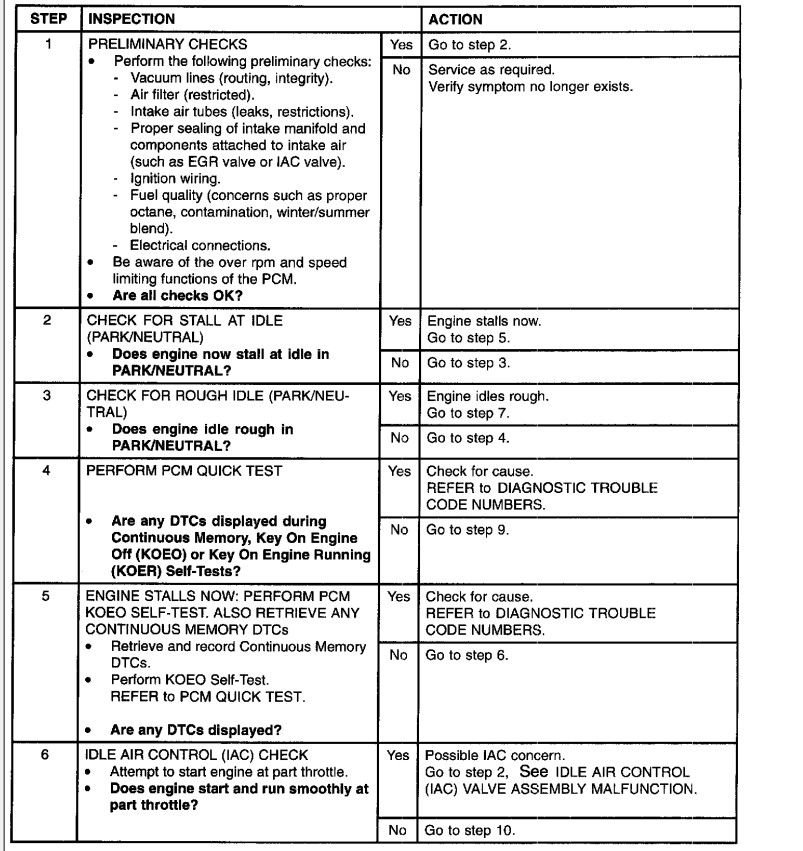

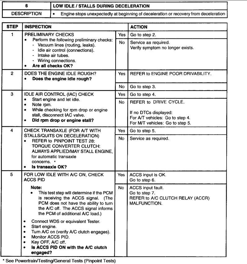

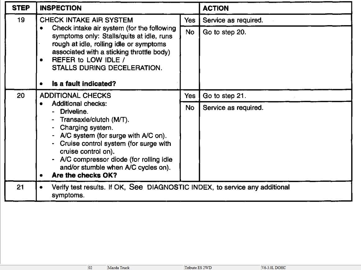

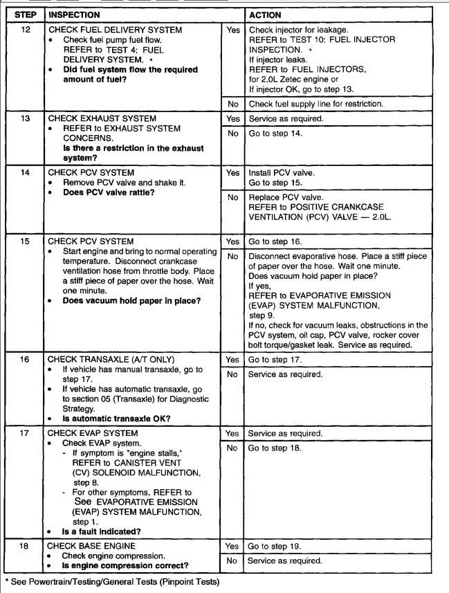

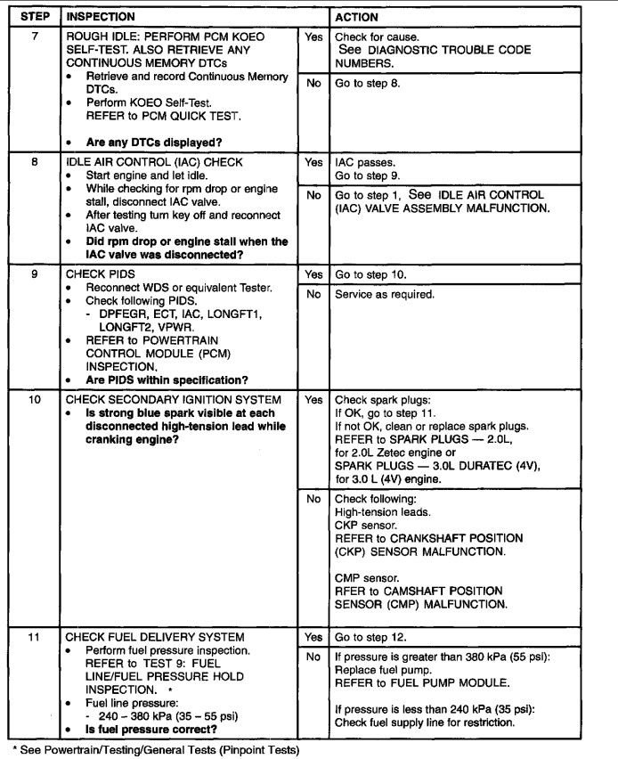

Chart 7 shown below:
Chart 4 above.
Chart 5 below:
Chart 6 below:
Let me know if you need more charts.
Also download the intake manifold pdf below so you can identify and locate the relevant components when checking for vacuum leaks.

Old Apr 11, 2026 | 01:22 PM
Chart 7, 21 steps must go thru all that first.
