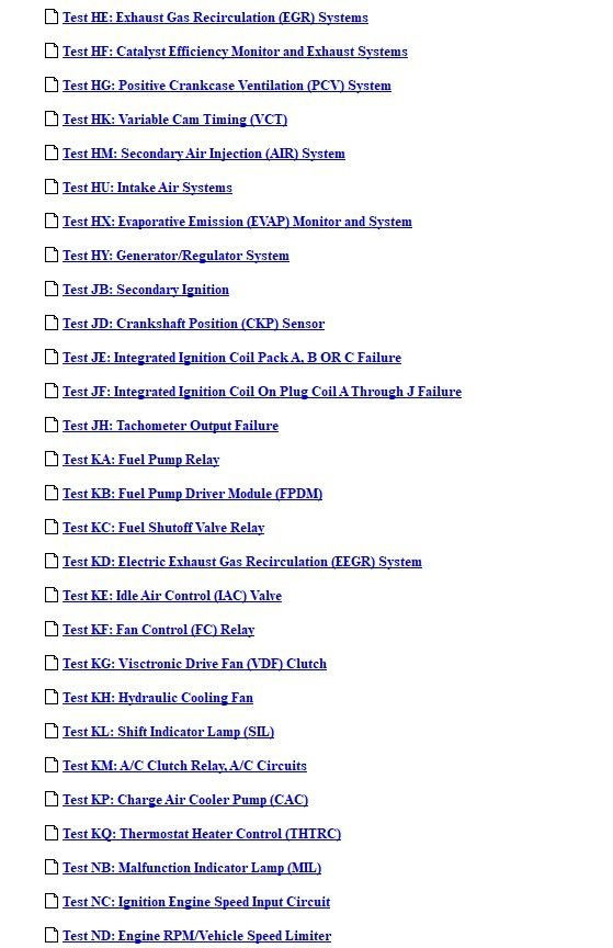

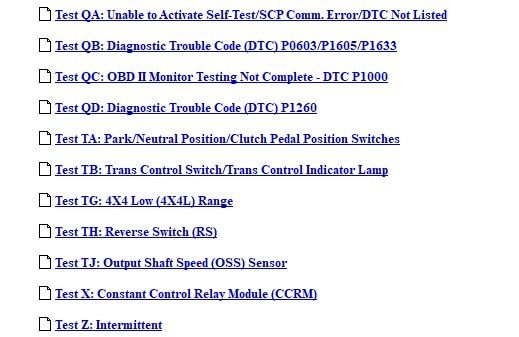

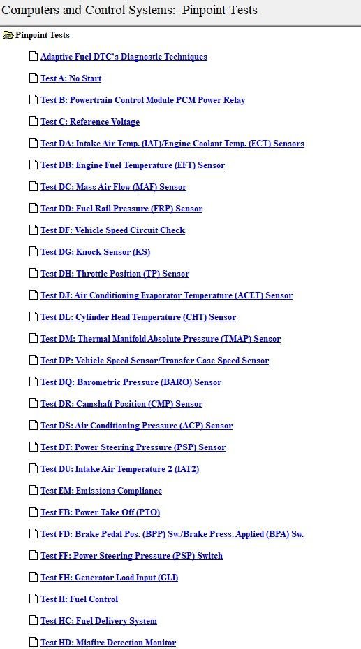

I found more diagnostic details on Escape than Tribute. I picked out a few and PDF'd them. If you want to view all download the huge pdf Pinpoint-Tests-ALL below, just that the huge pdf is very difficult to follow.
Here's the index page:
