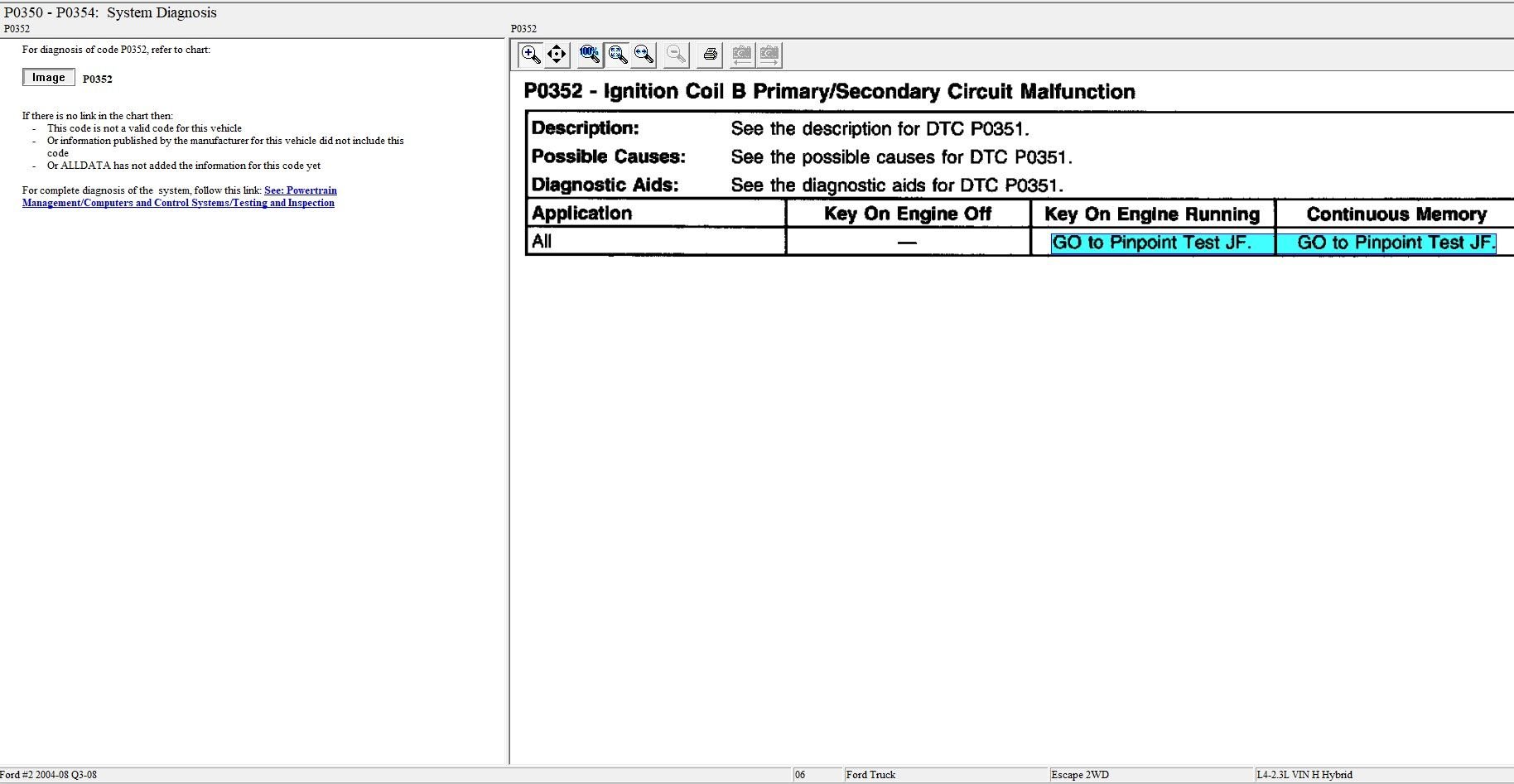

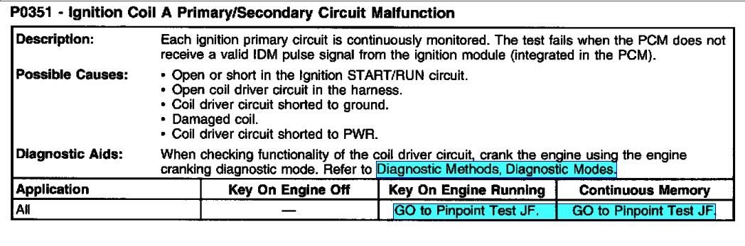

Posts: 1,243
The P0352 diagram above mentions about P0351 so here's the diagram for it.

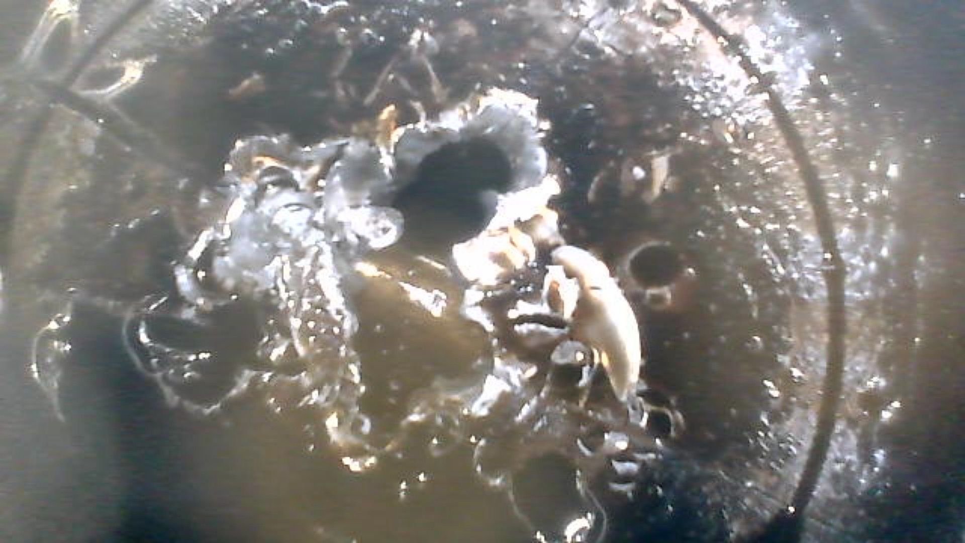

Ok, so I found out why it won't run. The piston in cylinder 3 has a hole in it. I wanted to swap the spark plugs around to see if the issue would follow. The spark plug in cyl 3 would not come out. I knew immediately something was wrong. Once I got it out, the electrode end was mangled and gone. Here is a picture of the piston.
I'll donate it to charity or to the local high school automotive shop.
Only left is to see if I can figure out what happened. I replaced the spark plugs, compared them to the old ones and everything looked the same. It ran great for 20 minutes and then it went down hill from there.
Any ideas?
