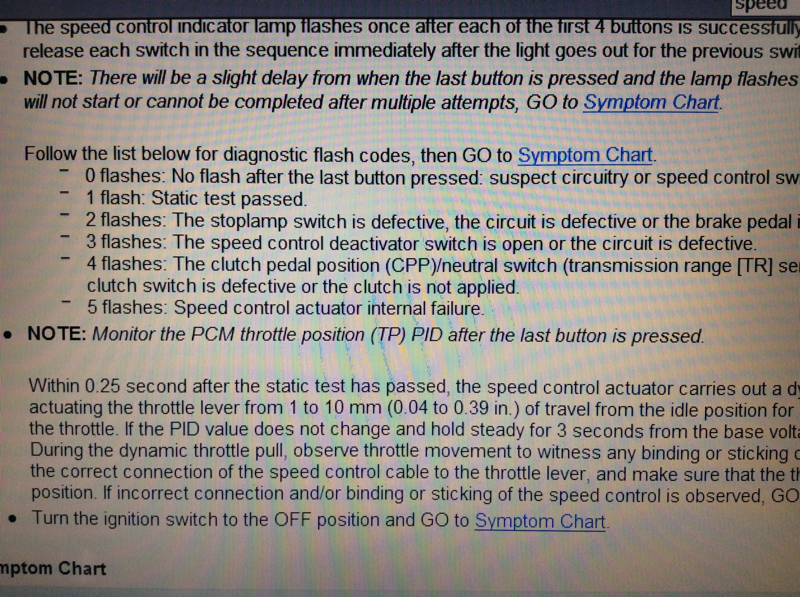

Ok I found this on the web, now I'm confused.
A lamp flash with the last button (SET/ACCEL) indicates that the static test passed. If the lamp does not flash with the last button and there are no additional flashes of the lamp, the switch is defective.
Well mine DID flash with each button that pressed AND I got the additional 4 flashes...
If the lamp does not flash with the last button, and additional flashes occur, follow the chart below for trouble codes:
2 flashes - BPP defective, circuit is defective, brake applied, CPP switch or jumper (if equipped).
3 flashes - deactivator switch is open or circuit defective.
4 flashes - vehicle speed signal is out of range or circuit is defective
Immediately (.25 second delay) after the static test, the speed control servo does a dynamic test by automatically actuating the throttle lever from 8 mm (0.315 in) to 12 mm (0.472 in) of travel from the idle position. During the dynamic throttle pull, observe throttle movement to witness any binding or sticking of the speed control cable and correct connection of speed control cable to throttle lever. Make sure the throttle returns to the idle position.
So now what? Mine did flash after each one was pressed AND I got 4 additional flashes... This is really confusing the hell outta me

Flash code 4 shows to be Trans Range Sensor to Speed Actuator fault/open..
I'll send you some tests points and connector views to your reg. email.. Think LFC #4 start about page 36..
If your able to do the checks, let me know the results.
