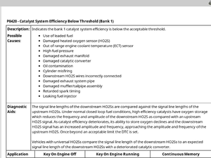

  #49
P0420

My Haynes book doesn't list the P0420 code so I have no idea.. My Escape doesn't act funny or anything. I have NO idea how to even begin to check any of that... I do know that we installed a tow package on it and while under there we had to fish the bolts and stuff through to bolt up the hitch and my exhaust and everything looks good.... It's not loud either, like a hole in the exhaust... I haven't lost any power (which I've heard will happen if the catalytic converter is bad... I also don't smell gas either.
